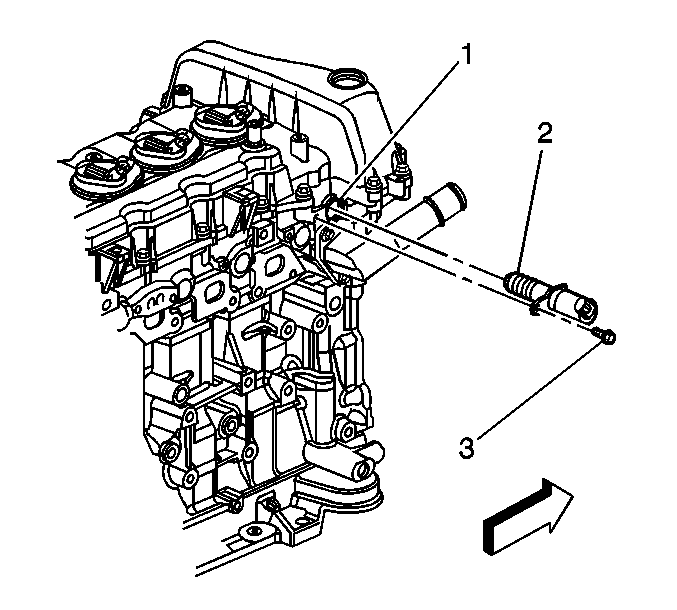

replace the cmp

You said to replace the cpm and I got the pictures but what exactly is the pcm.
Old Apr 17, 2014 | 04:38 PM
Posts: 9,047
Typo. Camshaft Position (cmp) Actuator Solenoid. OE part # 12615873
http://www.ebay.com/itm/Camshaft-Pos...aac66e&vxp=mtr
Dorman 917-010
http://www.ebay.com/itm/GM-Variable-...6753f5&vxp=mtr

Old Apr 17, 2014 | 06:29 PM
Posts: 9,047
No problem, Just make sure your engine oil is clean or change the oil before you install it. GL
Old Apr 17, 2014 | 08:10 PM
Kevin Lawson's Avatar
Joined: Feb 2013
Posts: 13
Ordered the part just a few minutes ago and changed the oil two days ago.
Old Apr 18, 2014 | 05:18 AM
Posts: 9,047
When you remove check for a screen missing on the old solenoid, could be lodged in the port or may have already been removed on your oil change. GL
Old Apr 21, 2014 | 06:44 PM
Joined: Feb 2013
Posts: 13
Replaced the cmp and it FIXED the problem. Thanks a million. Now maybe my wife will be happy. Thanks again
