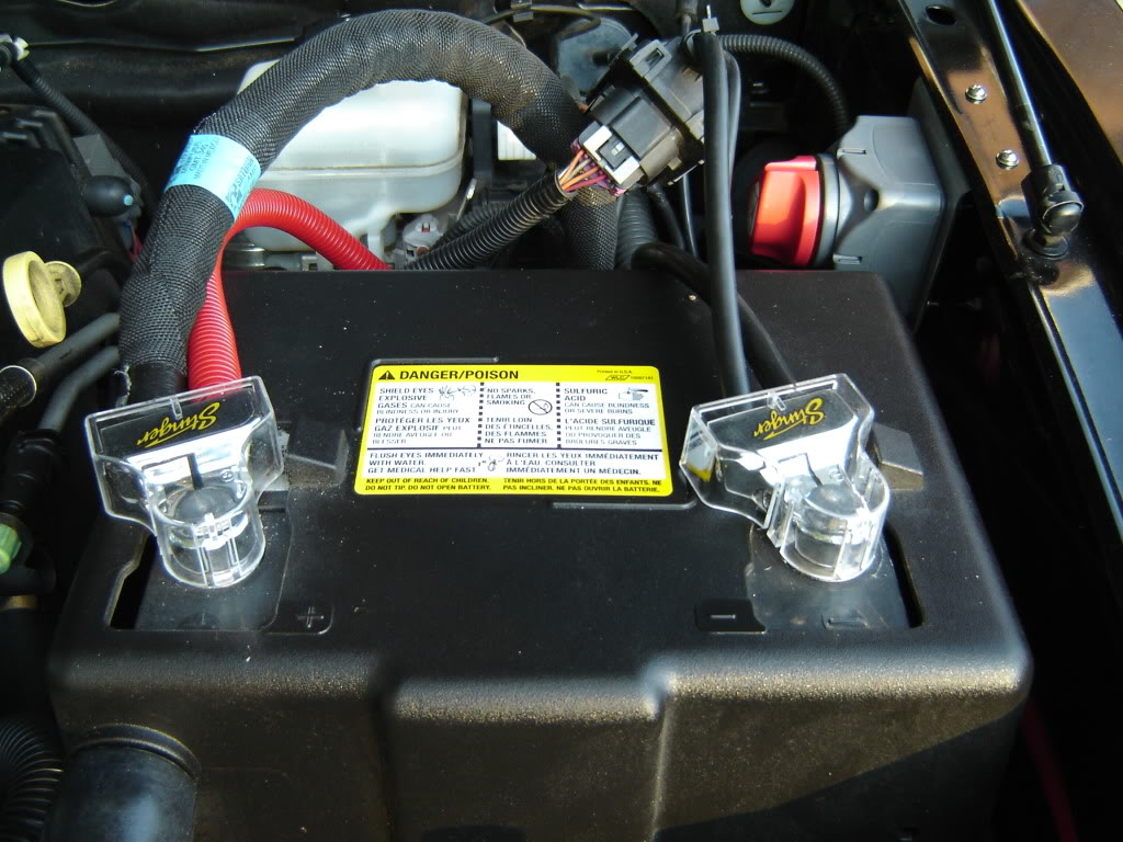

Cut of the OEM crap, strip back a bit of wire insulation, and install new high quality aftermarket terminals, like Stingers. I would not bother with the auto parts universal stuff either. The audiophile guys use these terminals for their audio competitions, tons of info out their, just pick your brand.
