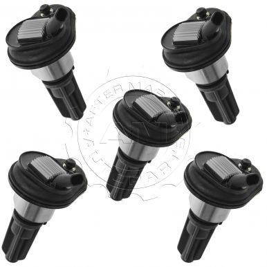

Purchase 1 new coil pack and move it around and determine effect. Depending upon miles and condition it would be wise just to replace all 5....also check for vacuum leaks. Do you have a code?

Purchasing a 5-pack of coils is cheaper per coil, than 1. You can get all 5 coils online for under $100.00 shipped (under $20.00 each). Replace them all and save the old coils.

Where can I look online for the coil packs

My 06 was doing the same thing changed all five at once and boom
Problem solved

Ordered them today. Will let you know how they work when I get them next week

Update. 2006 H3 101500 miles. Was missing. Cleaned MAF took throttle body off and cleaned, new AC Delco Iridium plugs and installed 5 new coil packs today. Runs much better but STILL has a miss in it especially at low idle. Check engine light is on. Have not pulled a code yet. What should I try next?
