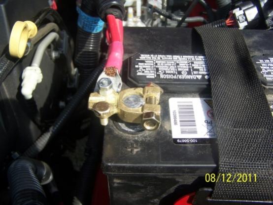

thats my next move. i did brass conn by cutting PART of the conn and used the bolts,,already there,,to connact to the new brass,,,no wires molested! good and super solid. 5 bucks for brass,,looks like gold. ill look for pics if u want

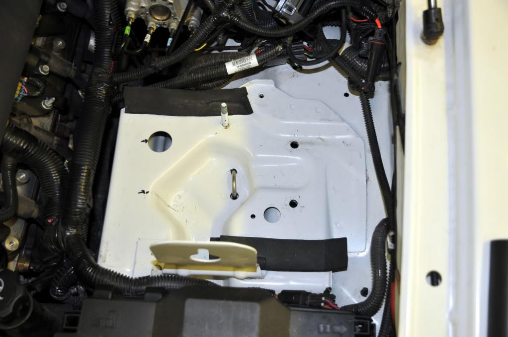

Optima won fit in the stock box, ditch it...

i love the factory crimp,cant be beat,except by hunner,,,and his pals giant shop!!
see also ,maybe hunner batt tray??
those other cutsie "batt bling"connectors use itsy bitsy set screws not meant for man sized cars!
the brass is cheep n ugly,,lifetime guarantee!! note it uses part of your existing conn, the bolt thru the brass and factory crimp,,,rock solid
ready for winch install,see brass bolt for accs!! solid ,,no set screws
Attached Thumbnails 06 H3 electrical trouble-brass-batt-term.jpg   06 H3 electrical trouble-somebodys-batt-shelf-.jpg
