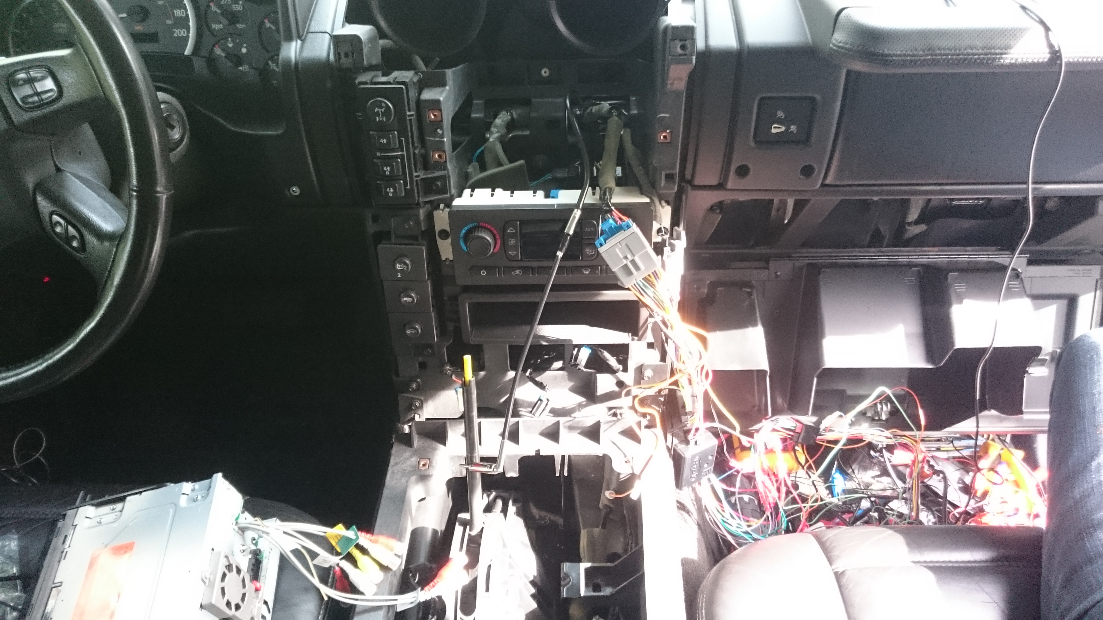

This is what is involved in accessing the stock radio, ignore everything after the main DIN connector left and right, that's just wiring for the new radio system.
This link regarding kit is worth a read and also this one dealing with dash removal , plus all the related posts, its a subject well covered.
