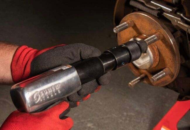

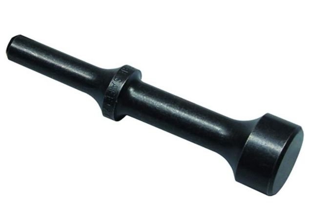

Use an air hammer with a blunt bit and hit/vibrate the bottom & sides of t-bar at lca.
