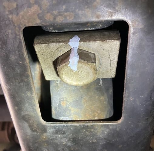

Don't know what you mean by "torsion tool" but just removed one of mine a few weeks ago when replacing my catalytic converter. It's not difficult to do and yes, you need to have the front lifted and hanging free (with jack stands, of course) in order to remove. Before you start removing the adjustment bolt, here are my recommendations along with a few supporting images:
  1. Use a paint pen, nail polish, etc. to mark the bolt's current positioning. After you've done what you need to do and go to install the torsion key again, you'll want to have the proper position marked to help you get it back to the exact height before you removed the bolt.
    marked positioning of bolt before removal

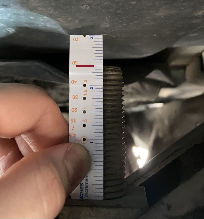

  3. Grab a small, cuttable measuring tool to measure the height of the bolt threads that stick up through the torsion key BEFORE removal (see image 2 below). I used this cheap bolt gauge tool that I had from Home Depot with rulers on the sides and cut it to 3 inches in order to reach up and measure from the platform area where the bolt threads through to the top of the bolt. It's really hard, if not impossible, to get your head up there to see the measurement so I held the ruler with one hand and my phone with the other and took a few pictures from different angles to make sure it was flat on the platform area and I was getting the correct measurement. FWIW i've seen some people say to count the bolt rotations after you've marked it but that's a lot of rotations to keep track of if you are removing the entire bolt. Maybe that's just for torsion bar adjustment when leveling but saw this method on YouTube and it worked out well for me.

Torsion bar should come out easily, followed by the key. Depending on what kind of shape the underneath side of your H3 is in, you might need to apply some force to remove the key. In my case, I did not have any problems with rust or anything like that and lightly knocked it once with a rubber mallet and then pulled it out. Saw a video of a shop using an impact hammer to remove the key but mine wasn't even close to needing that. Overall, it's really not a difficult job and shouldn't take too long. Just be sure to mark things as needed so that you can get it back in the same place from before you removed it. Not sure what the general consensus is for a basic torsion bar removal but I ended up going for an alignment a few days after I did mine, but that was because I leveled it, wasn't sure about the ride, saw some issues with my CV shaft seal and steering rack leakage, and decided to take it back to the original ride height. Hope this helps clear up any questions if you haven't removed it yet.
