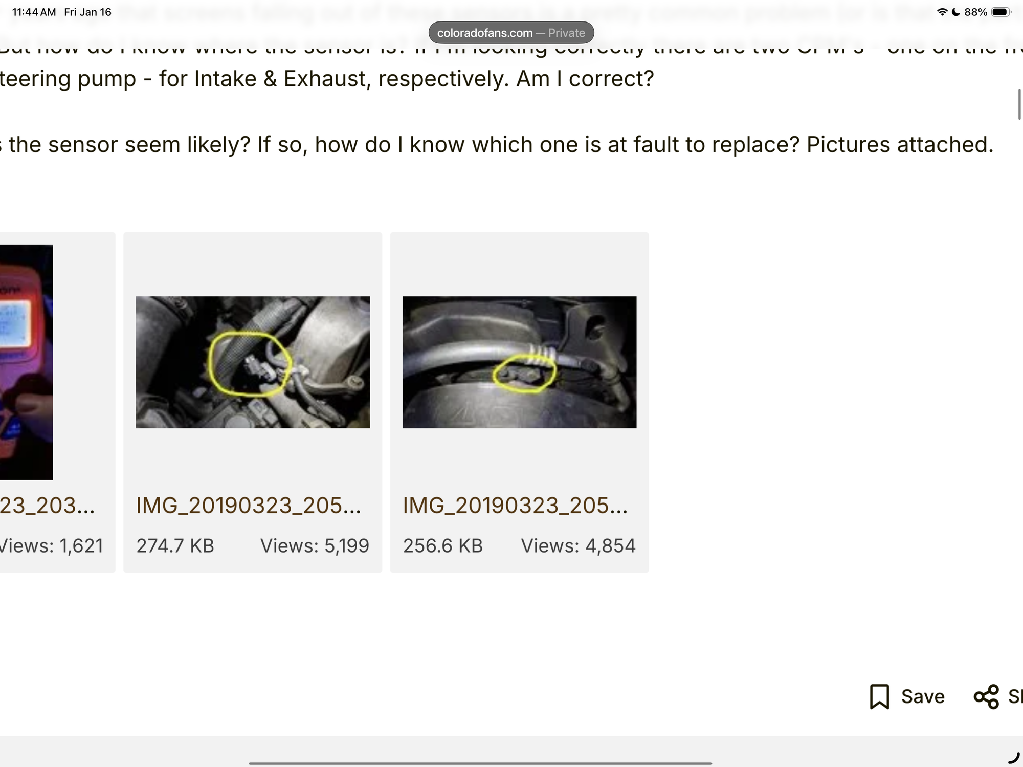

I’m getting conflicting information if there is only 1 cam position sensor, located on the passenger side towards the front or if there are two sensors and the silecond one is located on the front of the engine toward the driver side.
parts stores list these as exhaust side and intake Side which is dumb for our engines since they are both on the same side.
im also being told the one on the drivers side isn’t a cam position sensor but an actuator
This is for what is referred to as the “intake(driver) side” cam position sensor GM Genuine Parts 213-1649 difficult to find.
I don’t know if that one would actually throw the code in getting p0341 as I’m understanding it’s an actuator not a sensor.

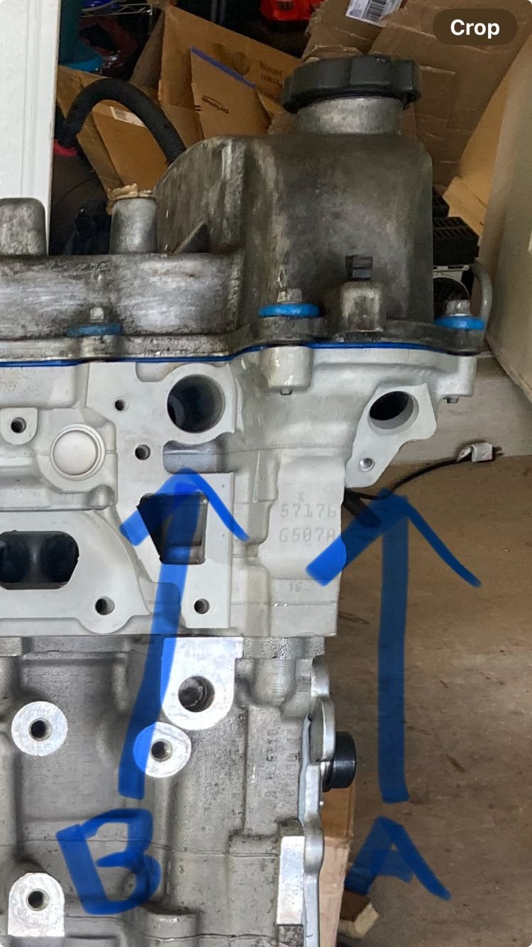

On the 2006 and 2007 I5 engine, there are 2x Camshaft Sensors (one for the intake cam, one for the exhaust cam), AND a camshaft VVT actuator.
The Intake Camshaft Sensor is located on the front of the engine on the drivers side. Very easy to see.
The Exhaust Camshaft Sensor and VVT actuator are both located near the front of the engine, but on the exhaust side (passenger side) of the vehicle.
I’ve attached a photo. Arrow “A” is pointing to the location of the Exhaust Camshaft Sensor port while arrow “B” is pointing to the Exhaust Camshaft VVT actuator port.
In the 2008+ models of the 3.7, GM removed the Intake Camshaft Sensor so there was only an exhaust camshaft sensor and actuator.
Did your new engine come with new sensors, or did your mechanic simply pull the old ones from your old engine? If they pulled the old sensors and reused them, I suppose you could replace both sensors and the actuator and see if that helps, but realize that this is 100% simply throwing parts at the problem.
Realistically, I would be willing to bet (based on nothing other than speculation) that you have a wiring issue somewhere; tracing the wires from both sensors shouldn’t be terribly difficult either.

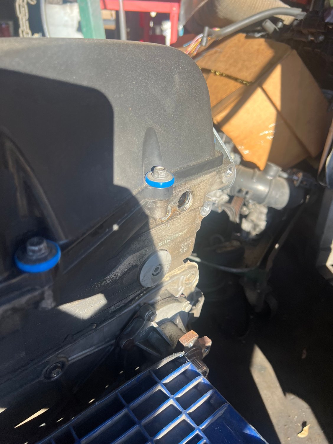

I just went and inspected my old engine and picked the mechanics brain a bit and might have put all the pieces together.
they reused my old the sensor on the front of the engine that is towards the drivers side. The one that came with the replacement engine was damaged.
this could explain why I’m getting the code I was getting 2 years ago.
he also mentioned that the wiring issue was limited to the coil for cylinder 5(rear) so maybe not related.
before I had even spoken with him I saw the empty hole for the sensor and put 2 and 2 together.
hopefully this solves the issue. I obtained the sensor that came with the replacement engine. It just had the latch knocked off. I’ll keep it handy and test it. Now just to find the sensor. I was trying to use all premium / genuine GM/ACDelco but this sensor isn’t available anywhere I’m checking. He suggested Denso as the next best.
my old engine with the sensor on the front missing
