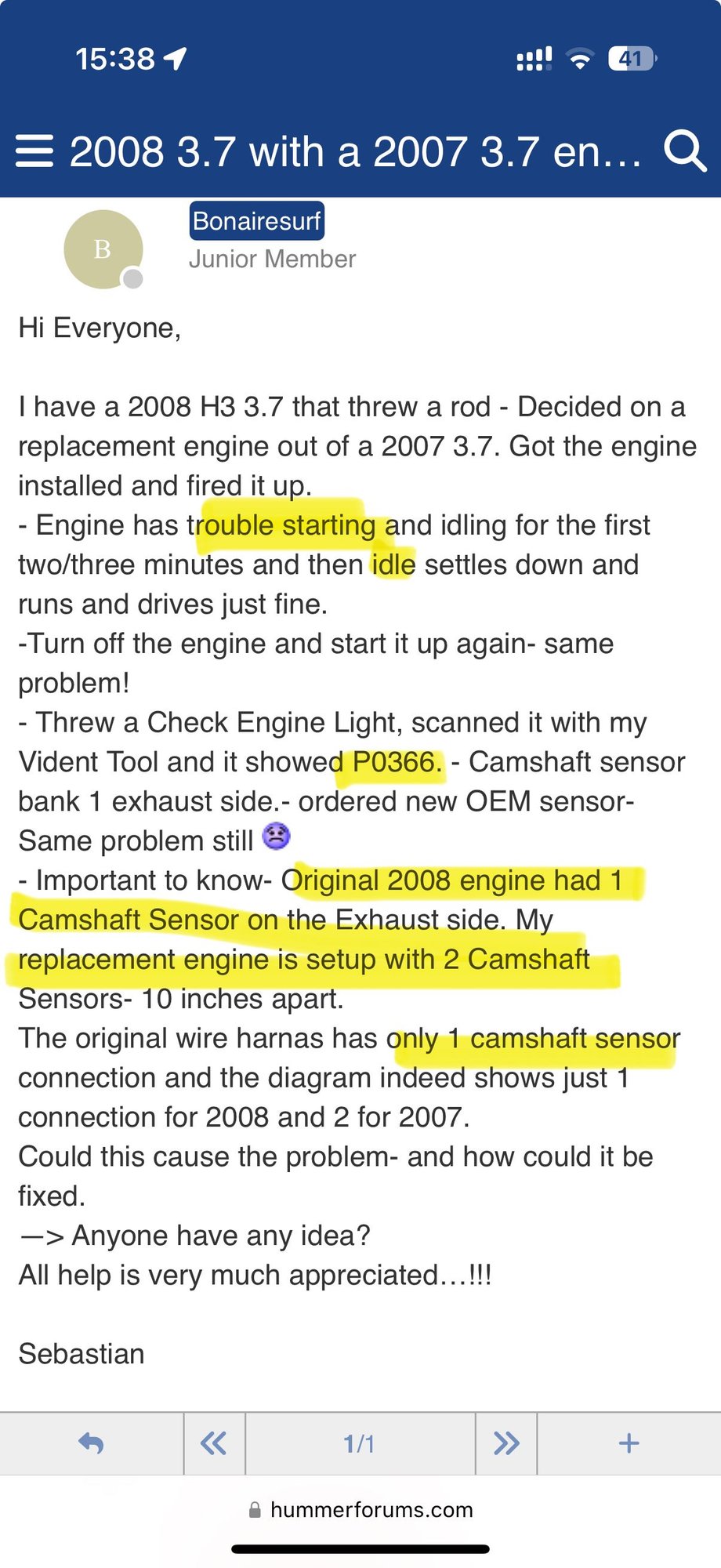

Hi Everyone,
I have a 2008 H3 3.7 that threw a rod - Decided on a replacement engine out of a 2007 3.7. Got the engine installed and fired it up.
- Engine has trouble starting and idling for the first two/three minutes and then idle settles down and runs and drives just fine.
-Turn off the engine and start it up again- same problem!
- Threw a Check Engine Light, scanned it with my Vident Tool and it showed P0366. - Camshaft sensor bank 1 exhaust side.- ordered new OEM sensor- Same problem still

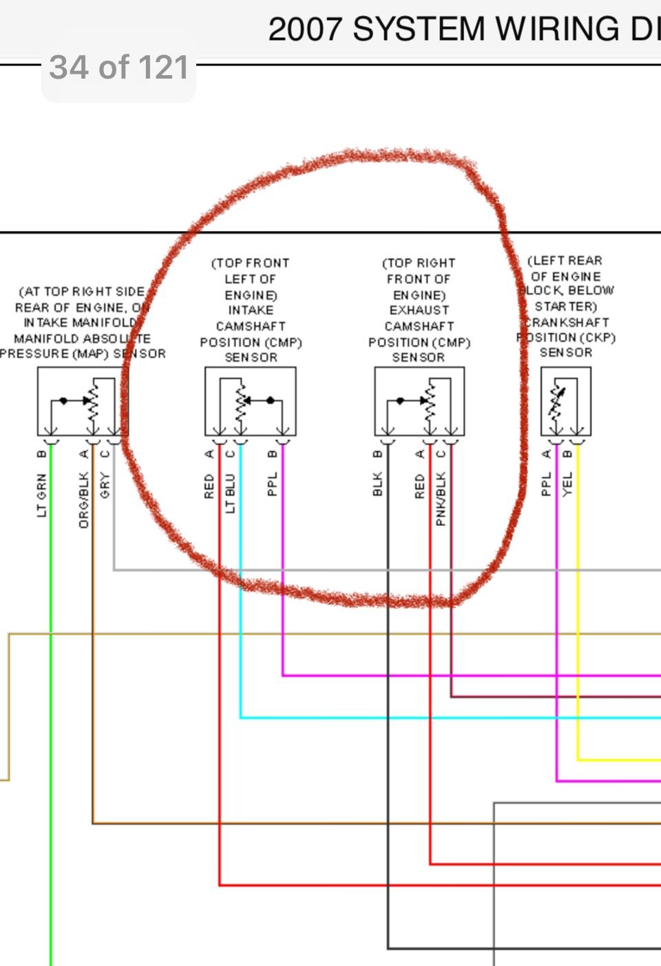

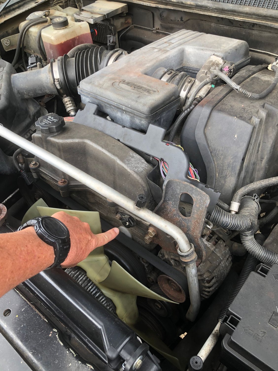

- Important to know- Original 2008 engine had 1 Camshaft Sensor on the Exhaust side. My replacement engine is setup with 2 Camshaft Sensors- 10 inches apart.

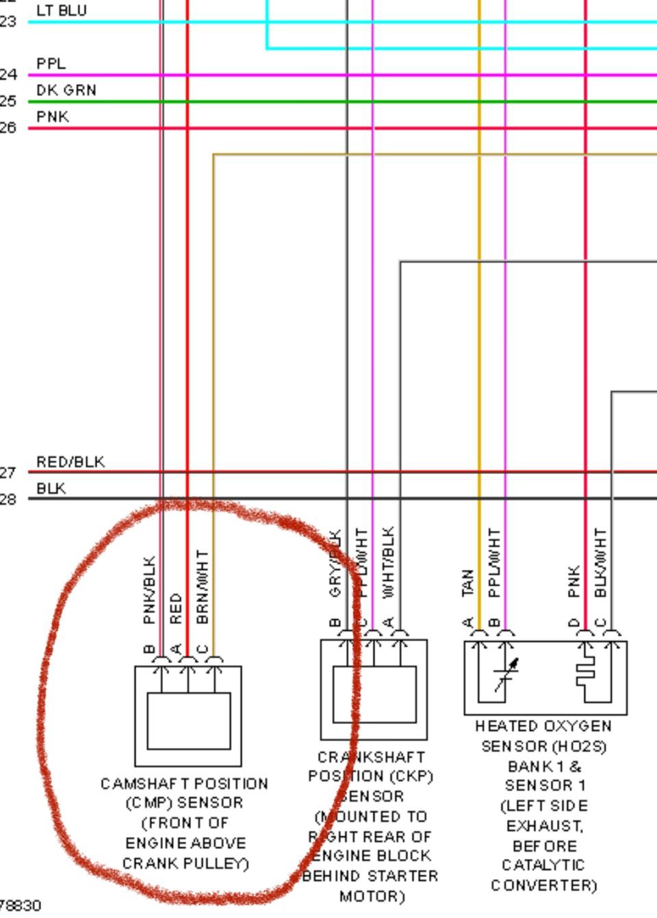

The original wire harnas has only 1 camshaft sensor connection and the diagram indeed shows just 1 connection for 2008 and 2 for 2007.
Could this cause the problem- and how could it be fixed.
—> Anyone have any idea?
All help is very much appreciated…!!!
Sebastian
2007 Replacement Engine Wiring setup with 2 Camshaft Sensors
2008 Wiring Harnas that is currently in my vehicle with 1 Camshaft Sensor
2007 Replacement Engine with 2nd Camshaft Sensor Location

Your 08 Chassis is set to only monitor the Exhaust CSS so the unplugged intake CS sensor should not be the issue.
