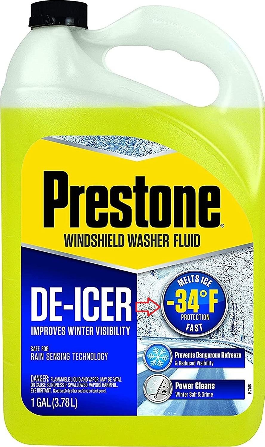

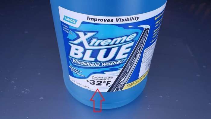

Some windshield washer fluids are advertised to only protect at up to +32F. Check labels before you buy!
