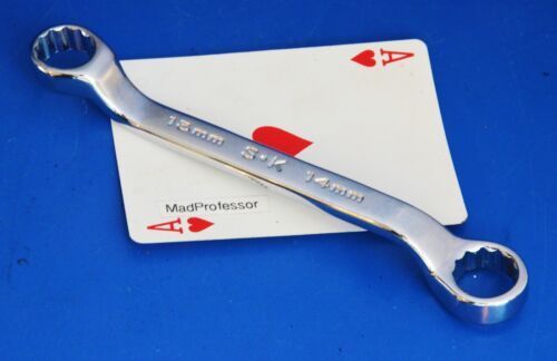

Old Oct 23, 2022 | 12:09 PM
RVR's Avatar
RVR
Joined: Oct 2019
Posts: 49
Originally Posted by MarkLovingood
Now on the converter bolts that for some reason are recessed in. So far no luck with a socket or torx socket.
Offset box wrench?
Old Oct 23, 2022 | 02:44 PM
MarkLovingood's Avatar
Joined: Aug 2022
Posts: 11
Default Got converter bolts out!!
The service manual suggests using a 18mm crowsfoot or short 50T torx socket. Not sure whoever wrote this has actually tried either of those. Here is a picture of all my attempts/ homemade tools. Yes, I broke an allen wrench welded to a socket. Big thanks to RVR for suggesting the offset box wrench. Don't know why I didn't think of that. My daddy always said that I wasn't the sharpest tool in the shed.

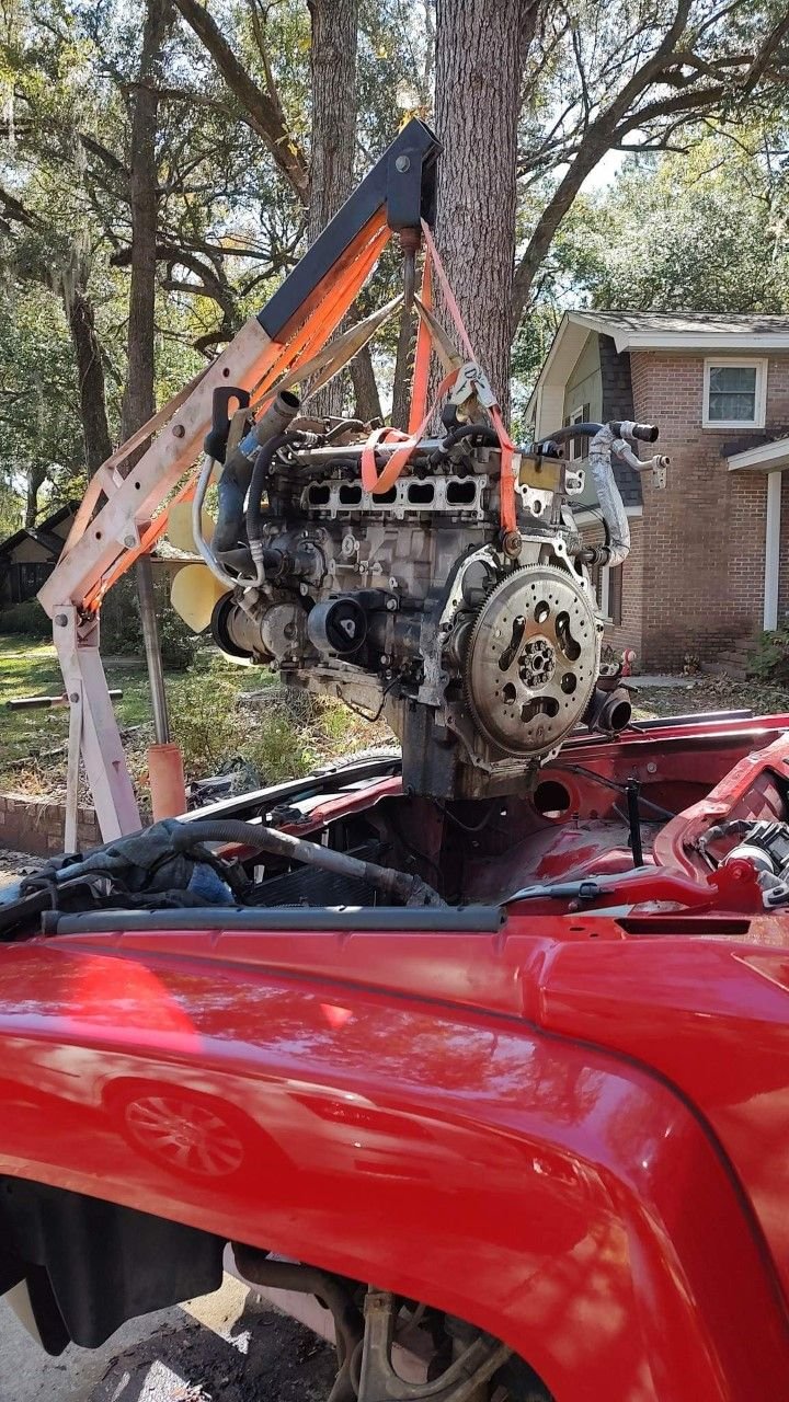

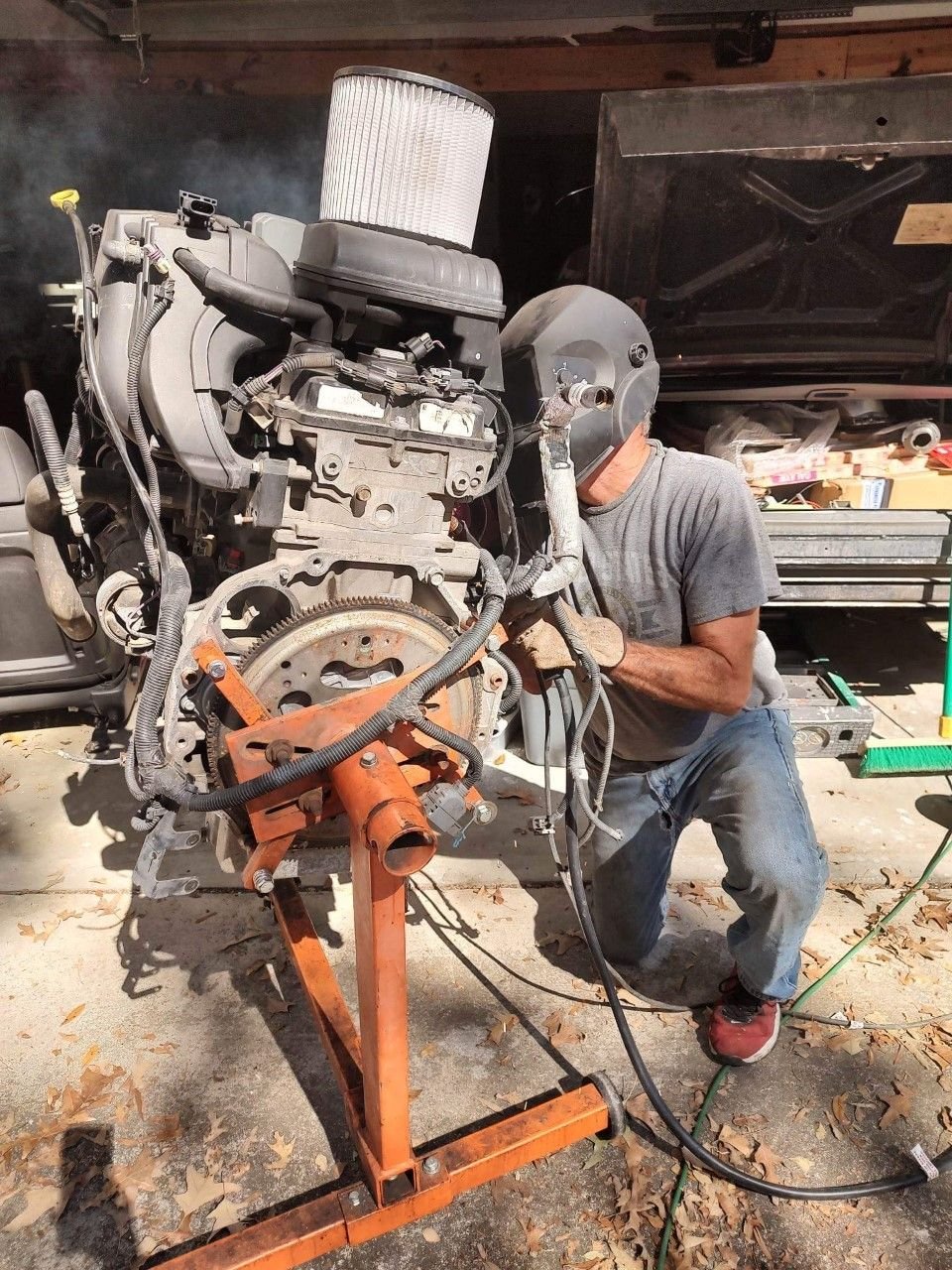

Old Oct 25, 2022 | 12:06 PM
Joined: Aug 2022
Posts: 11
Well, the engine is out. I'm cleaning up the engine bay and moving some parts over to the "new" engine. Which by the way, I noticed had 3 broken exhaust studs. Broke out the welder and got 2 out. The 3rd required drilling and easy out.
