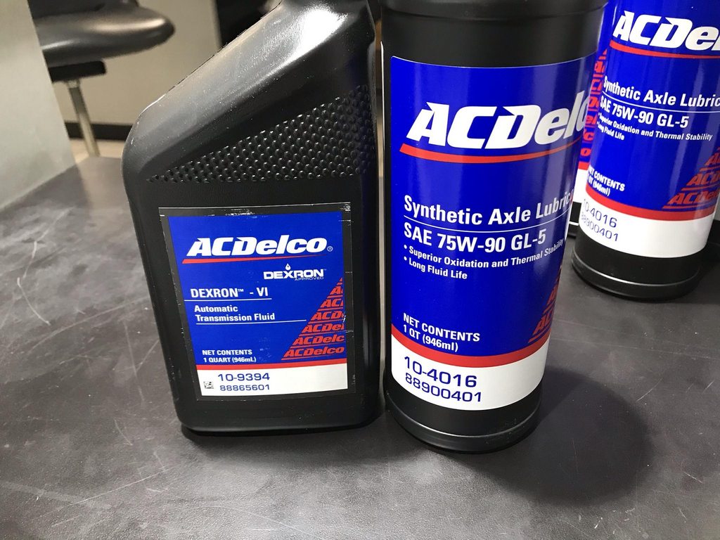

Need some help I stopped by the GM dealership to get the right gear and transfer case oil for my 07 Hummer. I gave him the VIN # it took him sometime to look it up and then called someone over to help him. I want to make sure these are the correct oil for my 07 These are what he gave me. He said I needed 5qts of the gear oil and I know the transfer case takes 1.6qts
Dexron VI 88865601
75W-90 GL-5 88900401
He also handed me a print out that shows a different part number 89021677 for the gear oil. I didn't noticed that until I left I didn't buy anything yet I told him I'll look into it and get back to him.
Any help would be great I don't want to install the wrong oil. Thanks

It looks like I can use Mobil 1 75W-90 SYN gear lube for both front & rear differentials
Mobil 1 site doesn't list anything for the transfer case but Rockauto shows to use VALVOLINE811095Synchromesh Manual Transmission Fluid.
So it looks like the gear oil listed on the paper he handed me for my 07 GM part# 89021677 was replaced by GM Part # 88900401 so I think I'll go with that but I'm still not sure what to use for the transfer case just yet.

Kidding aside I went with the Dex VI but then after further research drained it and purchased the exact ACDel GM product listed. It was visually different right out the jug. The thickness and smell were also different. Its been awhile so I don't remember all the stuff that encouraged me to swap to it but I'm glad I did.

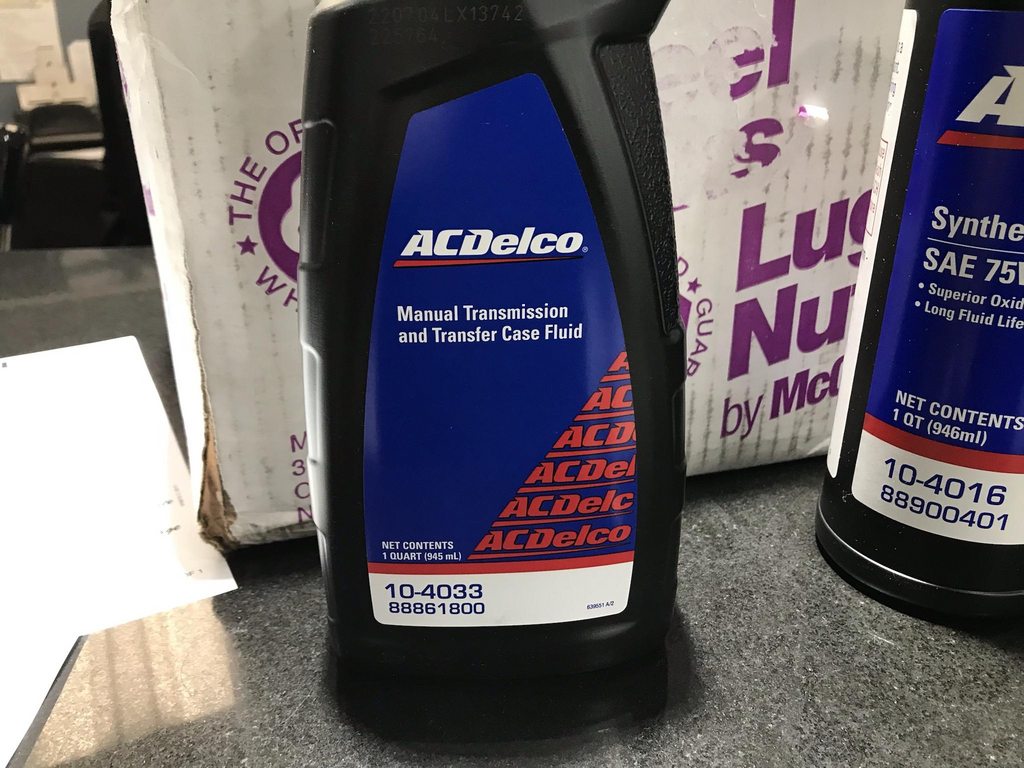

My issue has been resolved. I went back this morning to GM to pick up the gear oil. A different guy was at the counter I handed him the invoice from yesterday to get the gear oil, I also wrote the old part number for the manual/transfer case oil 88861800 that my owner's manual calls for, I told him about yesterday the other guy was telling me to use Dexron VI and he said yes, I was the other guy that helped him look it up and that's what GM calls for your 07 H3. I told him there is a service bulletin saying if your owner's manual calls for manual/transfer case oil 88861800 do not use Dexon VI he said no you can use it but once its in there you can't go back to the old stuff.
I kept pushing the issue with him and I said I know manual/transfer case oil 88861800 is not available and he said no we still have that but it for manual H3 only I said no it's also for the transfer case and showed him a picture of my owner's manual that states to only use that. He went back to get my two bottles and came back and said you are right it does say manual/transfer case.
It pays to do your research. Hope this helps others
