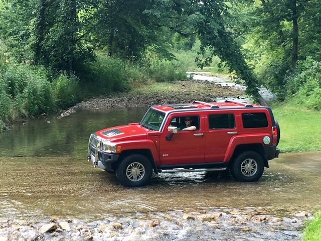

Red 2008 Hummer H3 Alpha with 304K on the clock. Cosmetically, looks like half the mileage and everything has been replaced at some point minus motor and front differential, which the latter just went. It has been in our family since new. I paid 3K for it from family member 4 years ago and put about another 3K in it in various repairs and upkeep. It was running beautifully until front diff went. I am having a hard time sourcing a front differential for it used or rebuilt. It will still drive in 4Hi Lock obviously. Anyone know of any reputable sellers who have used or rebuilt ones anywhere? Do I sell it cheap and just get rid of it? Fix it? Drive it as is? We have a Grand Cherokee and 4Runner TD Pro already and just use it as third vehicle. It's hard because I still really like it but also know it's not worth much because of its high mileage. What do you think?
