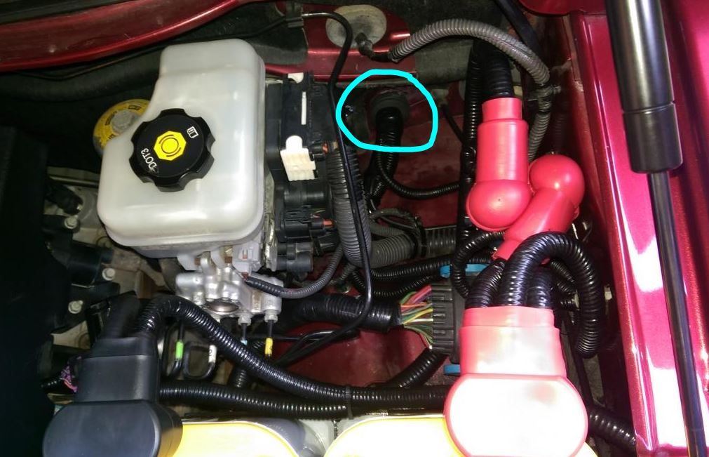

Thankyou very much. I've been playing with using the hole where much of the wiring goes thru the firewall. It's located near the brake master cylinder. I have some plastic conduit to keep separated from other wires. I don't think I be able to get everything thru there so I'm looking for a 2nd site also.

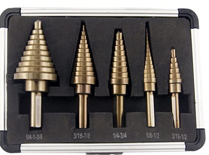

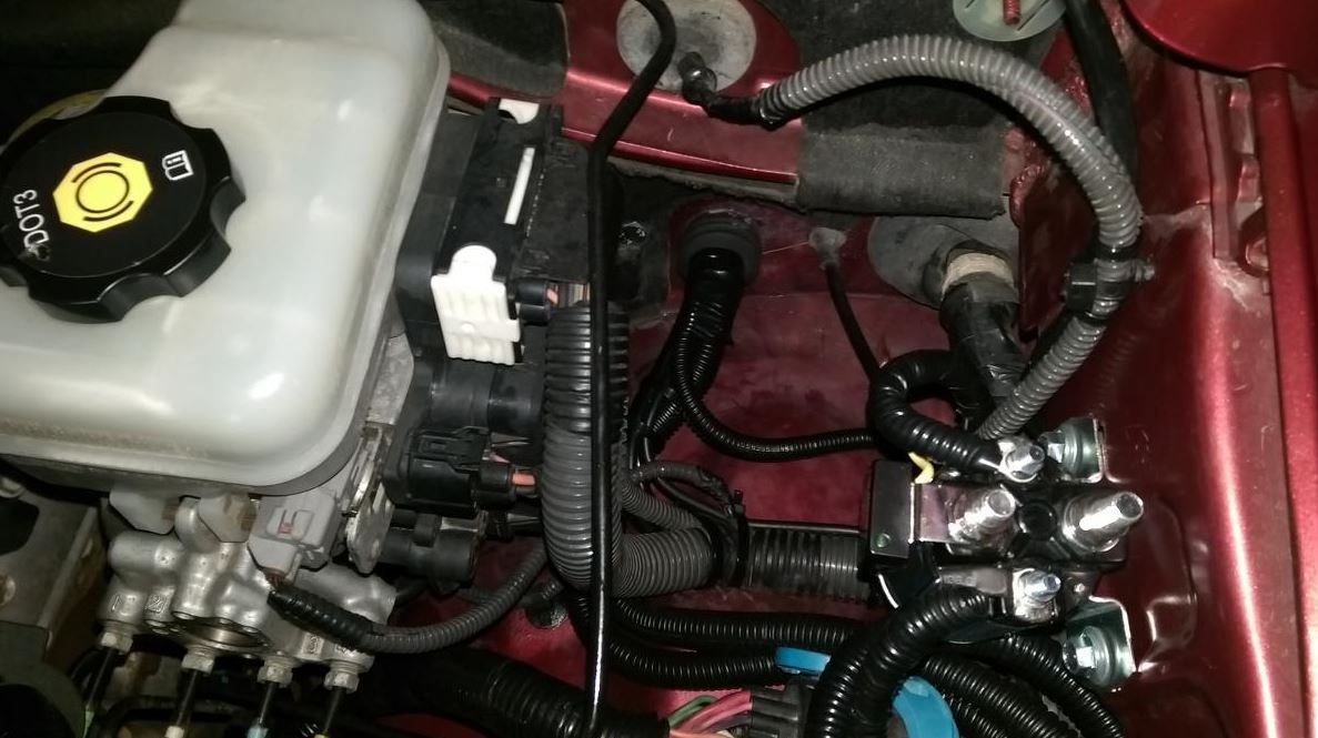

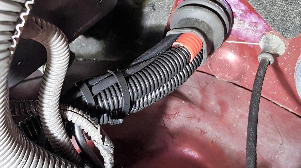

These pix should help.
I used a step drill for the appropriate size
Amazon Amazon

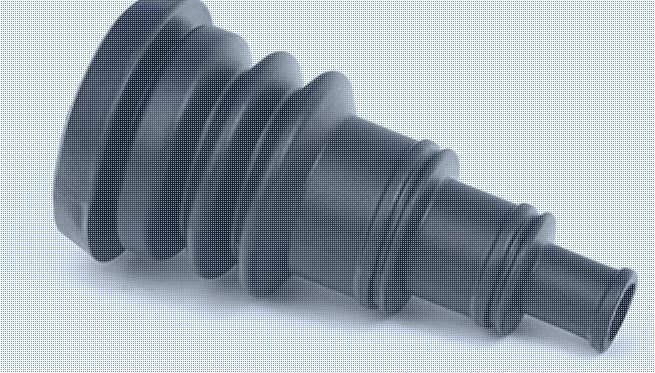

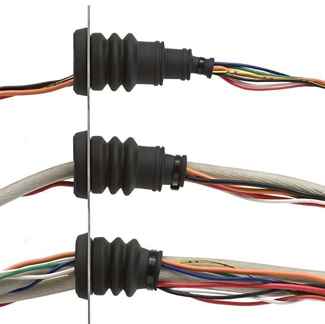

I used a daystar firewall grommet
Amazon Amazon

That about says it all...
That is an awesome grommet.
