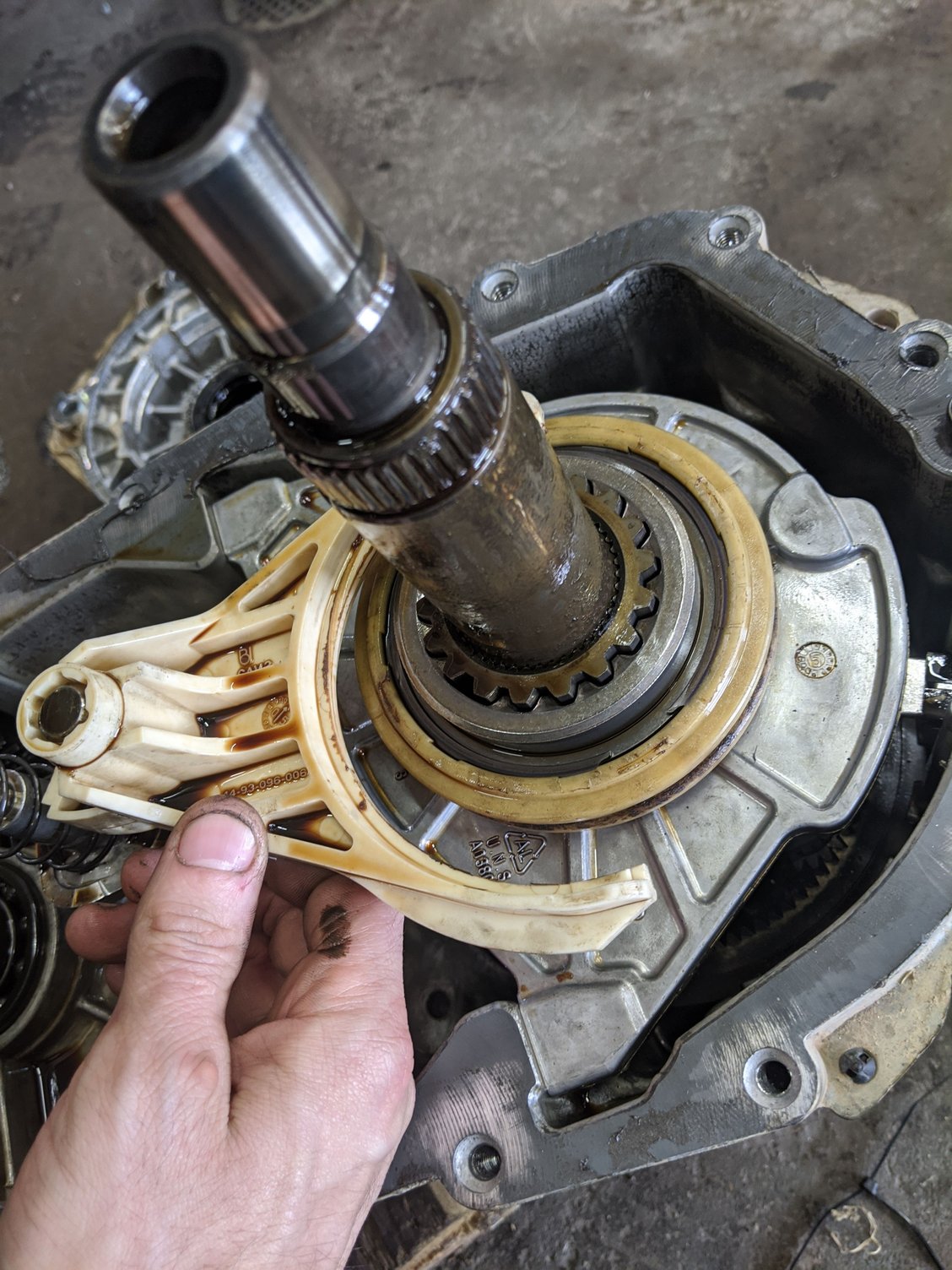

This isn't making sense. Just took it for a drive. Was fine pulling out of the shop and going around the building. But by the time I got to a stop sign a quarter mile away it felt weird and when I went to turn right at that sign you could tell it was in 4wd again. Same story, I switched the buttons back and forth a couple of times and then went to drive. Something popped and it freed up. But it was back to acting up by the time I got back to the shop.
Old Mar 9, 2020 | 12:19 PM
Look up H3 Transfer Case shift fork. It is almost always the range fork, but the lock fork can cause issues as well.
Just because you played with the T Case buttons does not mean you got it from lock to high. You still have to know that it can have pent up TQ that will not allow it to unlock until that is relieved. Have you tried backing up and turning back and forth in a safe area?
Old Mar 9, 2020 | 03:39 PM
Dozell's Avatar
Joined: Mar 2020
Posts: 9
I'm not an expert but I'm pretty sure these aren't supposed to be able to move independently of each other.
