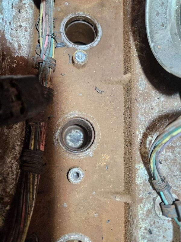

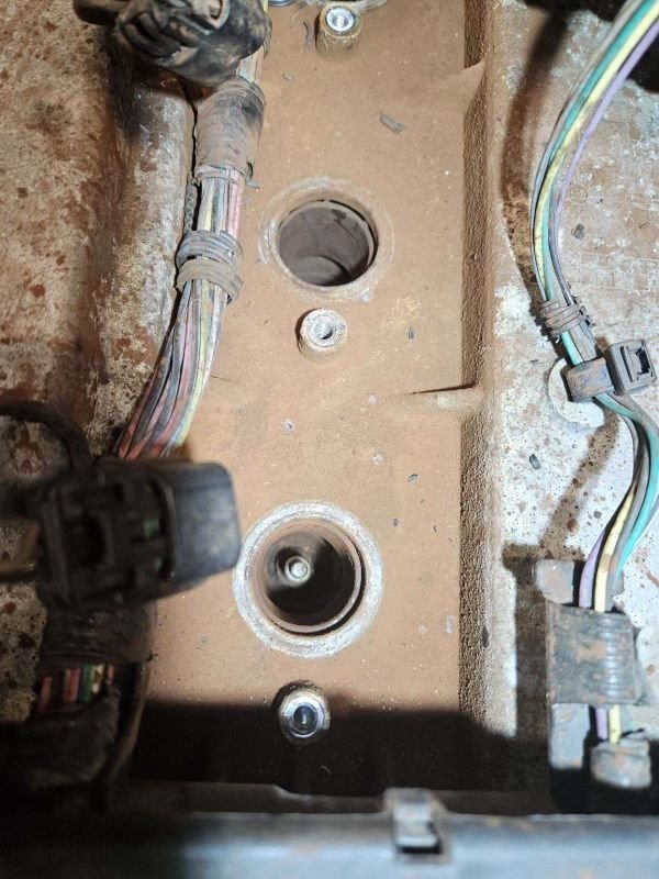

Yup got slapped with it as well. First plug was half gone. Second would just spin but wouldn’t come out. What are my options? Motor toasted? Can I get a new or rebuilt? Sell as is to someone who has a motor they want to swap out or deal with this. What would an as is price point be? It’s an 07 with less than 120,000 miles maybe, I don’t remember for sure. Just pissed off when I found this out and parked it a couple months ago. Thinking it’s about time to do something with it. Suggestions
Old Nov 15, 2024 | 02:17 PM
Remove the spark plugs, squirt a dab of oil in each cylinder, install ACDelco spark plugs and see what you have.
BTW there is no such thing as a spark plug that will not come out... use proper tools, grip it and remove. What water has to do with your plugs themselves having issues is beyond me. If the threads in the head are stripped, they make HeliCoils (and other knock off brands) in all sizes to take care of that. Dial back your panic button.
There are no new motors. Rebuilt motors are exceedingly difficult to find.
Good luck
