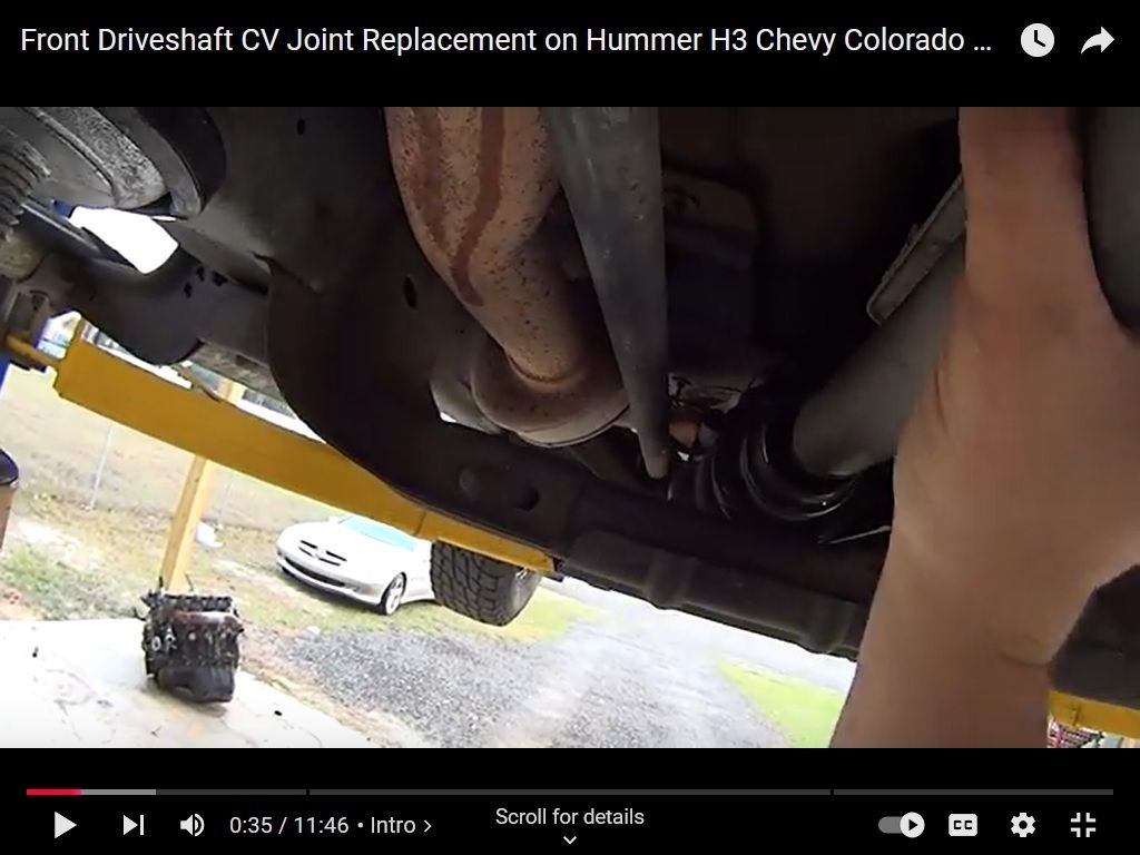

Does it sound like this (@0:35):

Just grab the shaft and check for movement as shown in the video above!
