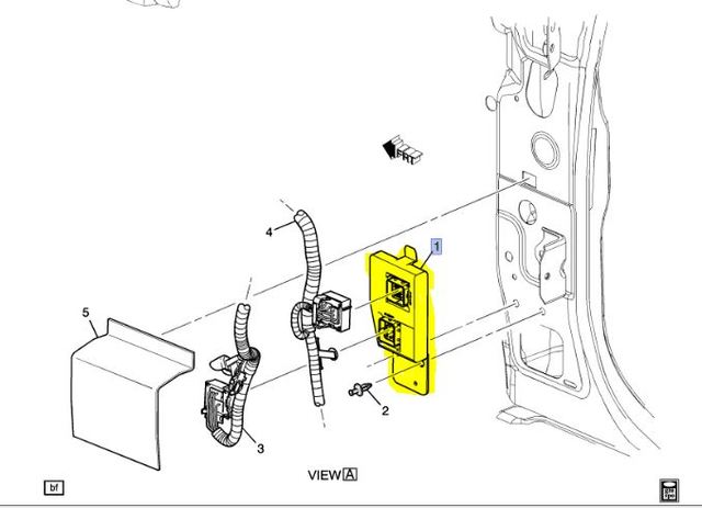

check your bcm as it is notorious for getting water damage. maybe you can still save it. don't wait till you have issues.
BCM? Computer Module? Is that under right side dash?

Posts: 3,204
