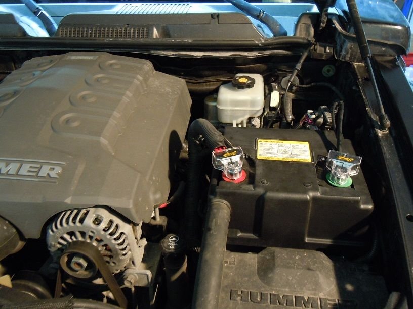

Alright, that is one of those things that can be cause by the crappy azzed battery terminal connectors. They suck, will fail and cause other issues as well. Replacing those with a quality aftermarket set id THE 1st Mod to do to every H3/H3T.
When I bought my second H3, that started to happen because it sat on the Toyota Dealer's lot, the battery died, they charged it, but the issue persisted. Their "technicians/mechanics" were clueless and could not correct it. I made a low offer conditioned upon them letting me replace the terminals and seeing the results. It was out of state, I just bought a cheap azzed Positive terminal at the local Auto Zone, hacked of the OEM for chit terminal, and problem gone. When I got it home, Stingers were the first addition I made. Never an issue since. The Yota Mechanics could not believe that did it.... Been there, done that.
First Day home, what I did when I bought it.
First Mod.
Easy stuff first. It could also be as simple as a bad connection in at the Transfer Case Actuator connection or compromise to its harness. You truck is OLD. Everyone with an old vehicle should have a can of CRC Electronic Cleaner on hand because connections and grounds will corrode and need attention. Disconnect the T Case Actuator, spray both the Connector and T Case side, let dry and make sure that is properly snapped into place when reconnected. See if it resolves. If not, trace the harness.
