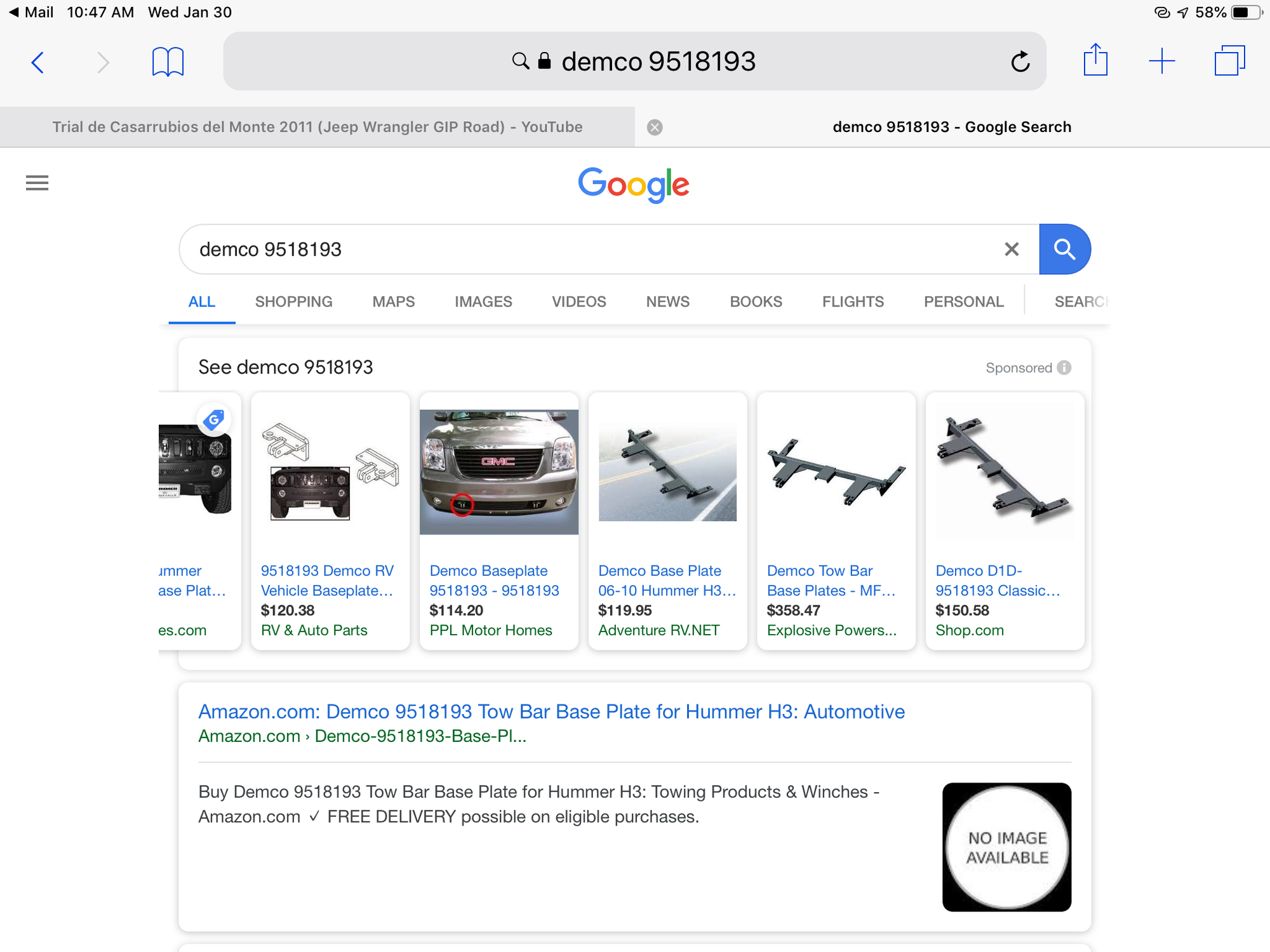

It looks to me like the complete bar was sold because it was made for the vehicle(s?) that shared the frame but had no hooks and then a hummer h3 specific fix came out? The photo shows both with almost the same part number. I’m just curious if the tow hook points are strong enough because the cross-member would be so far back. The 400 one that provides a cross-member might be harder to install. I don’t want to go to the trouble if it’s not necessary.
Old Jan 30, 2019 | 10:06 AM
Kim Kietzman's Avatar
Joined: Dec 2018
Posts: 24
As I search more, I’m finding the two types for the same price so it comes down to easier installation. I’ll look for installation instructions for both.

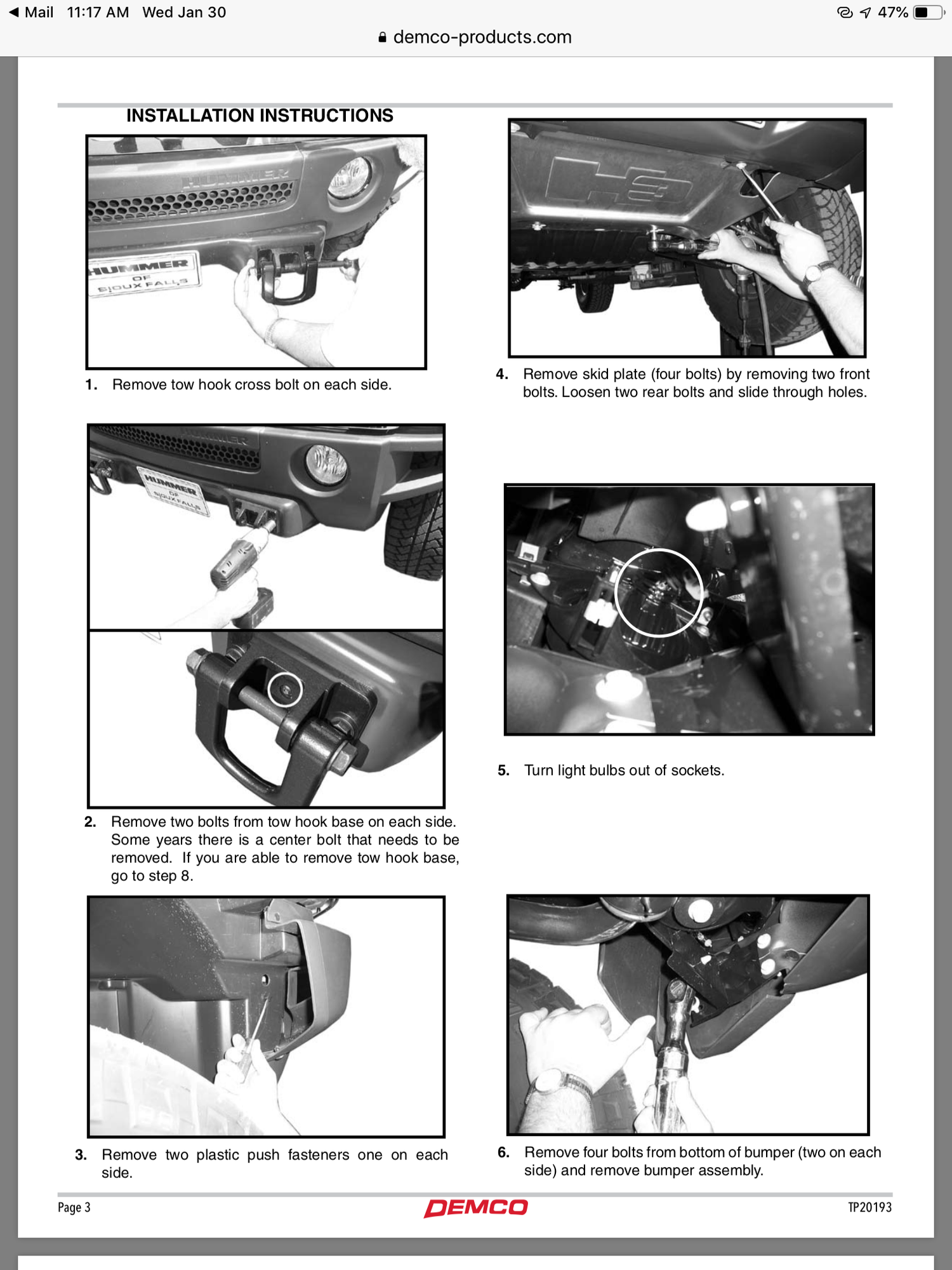

Default Demco install
Install all seems easy. Is it strong enough?
