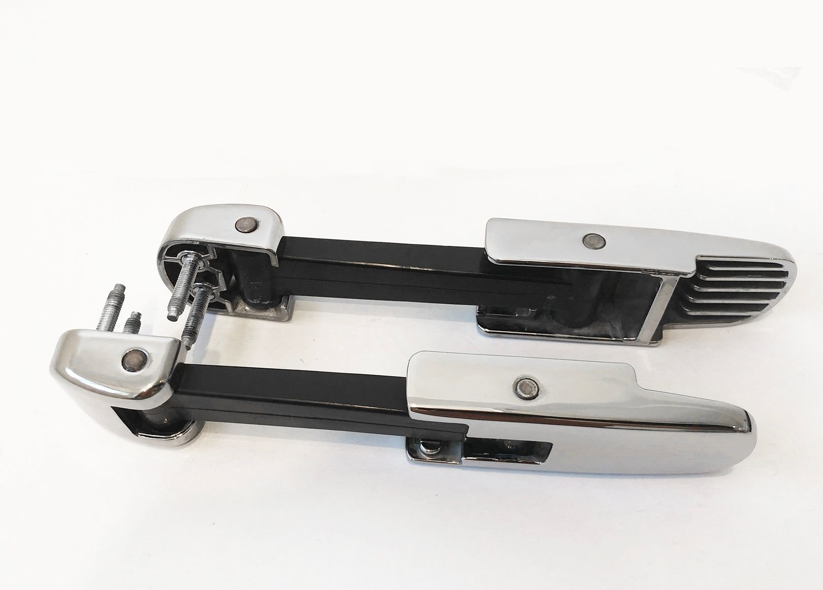

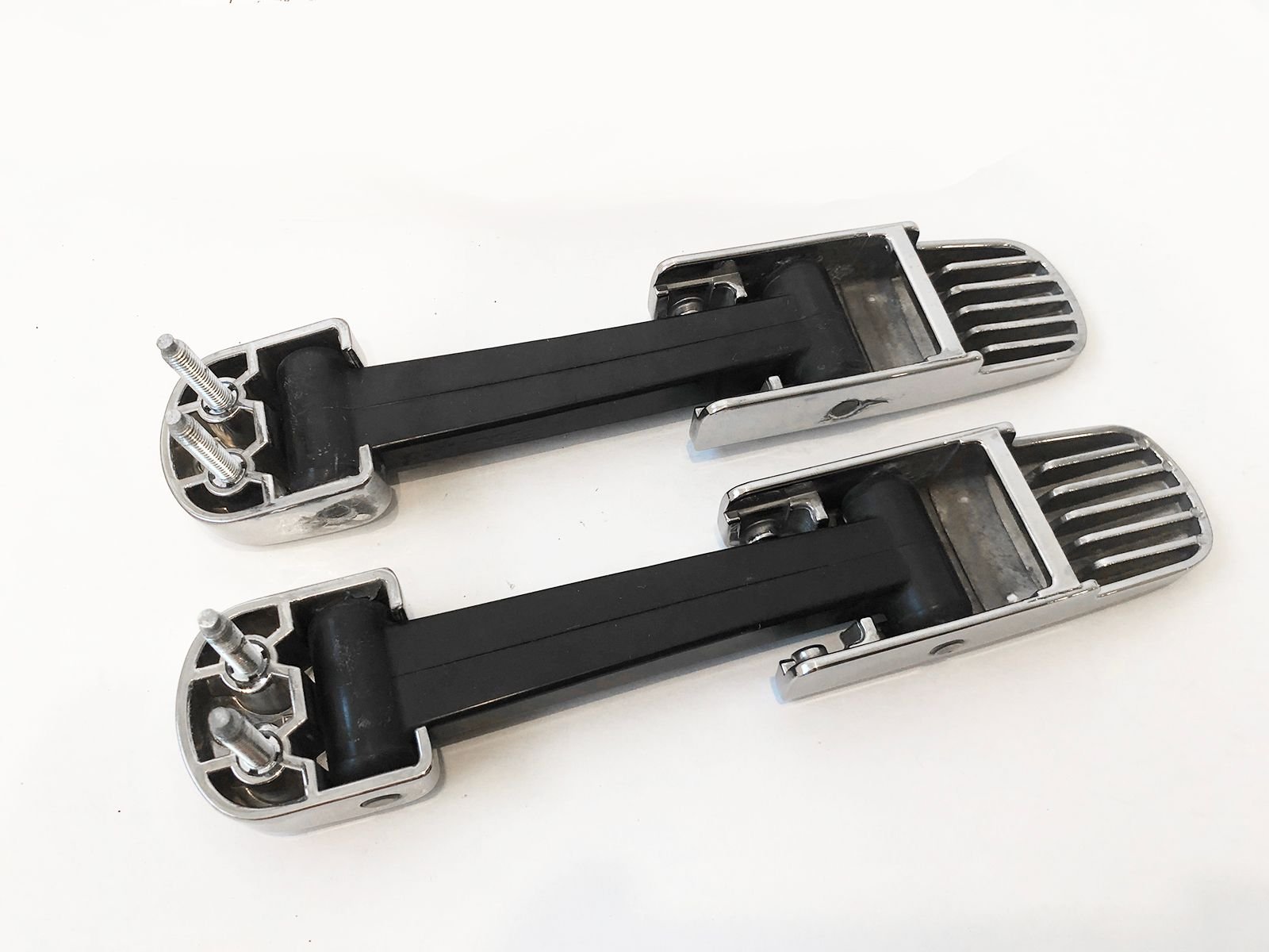

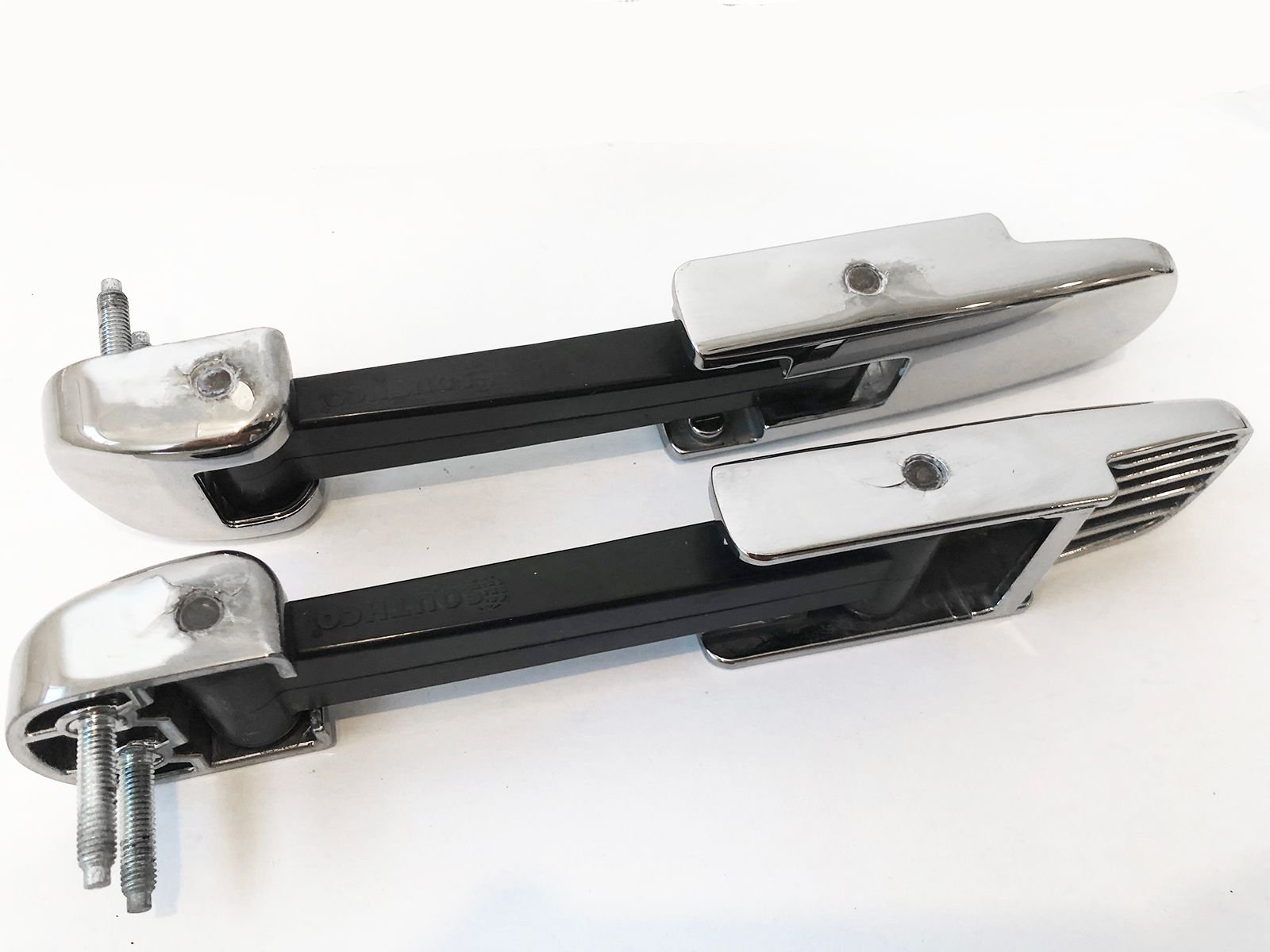

To put this insanity to bed, buyer will get the ones that got shipped on my 07 H2 SE from the factory.
So buyer knows they are OEM without a doubt.
The ones pictured in detail below. They fall under one of the 5+ part numbers listed in this thread.
These are USED condition.
Pretty much perfect on the 3 sides you can see. Some chrome peel on the bottom side, that is not visible when these are mounted on the vehicle.
