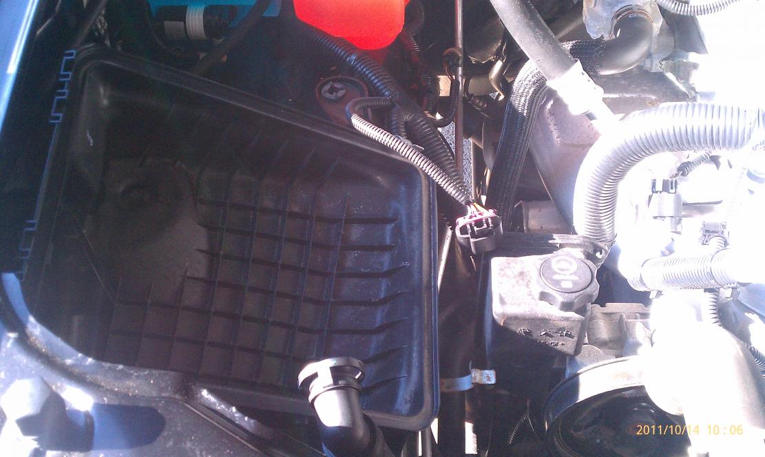

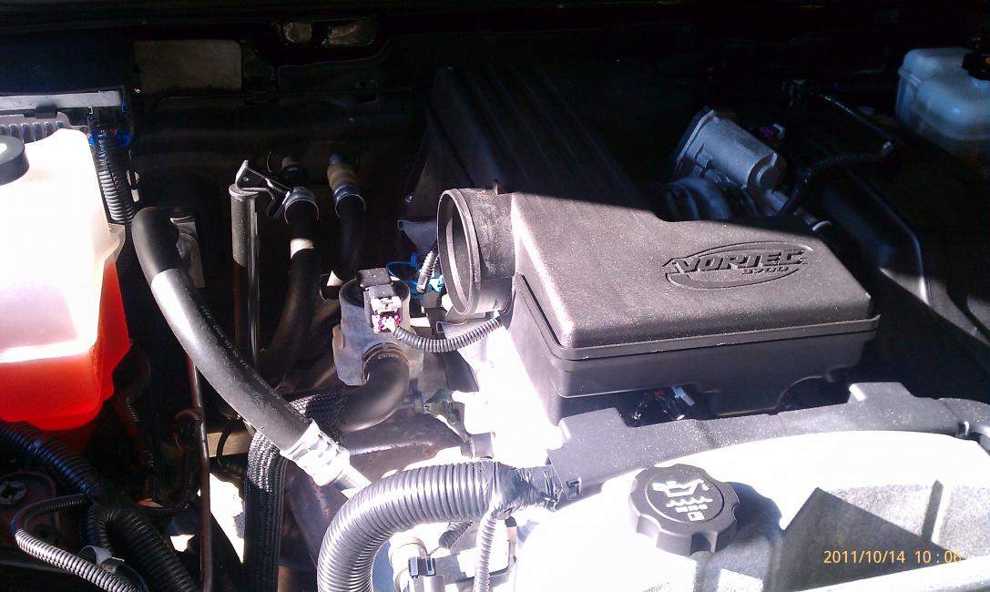

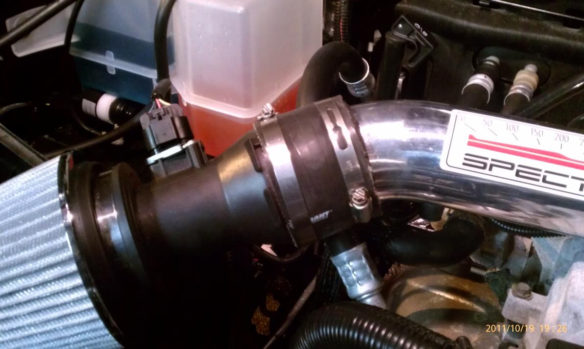

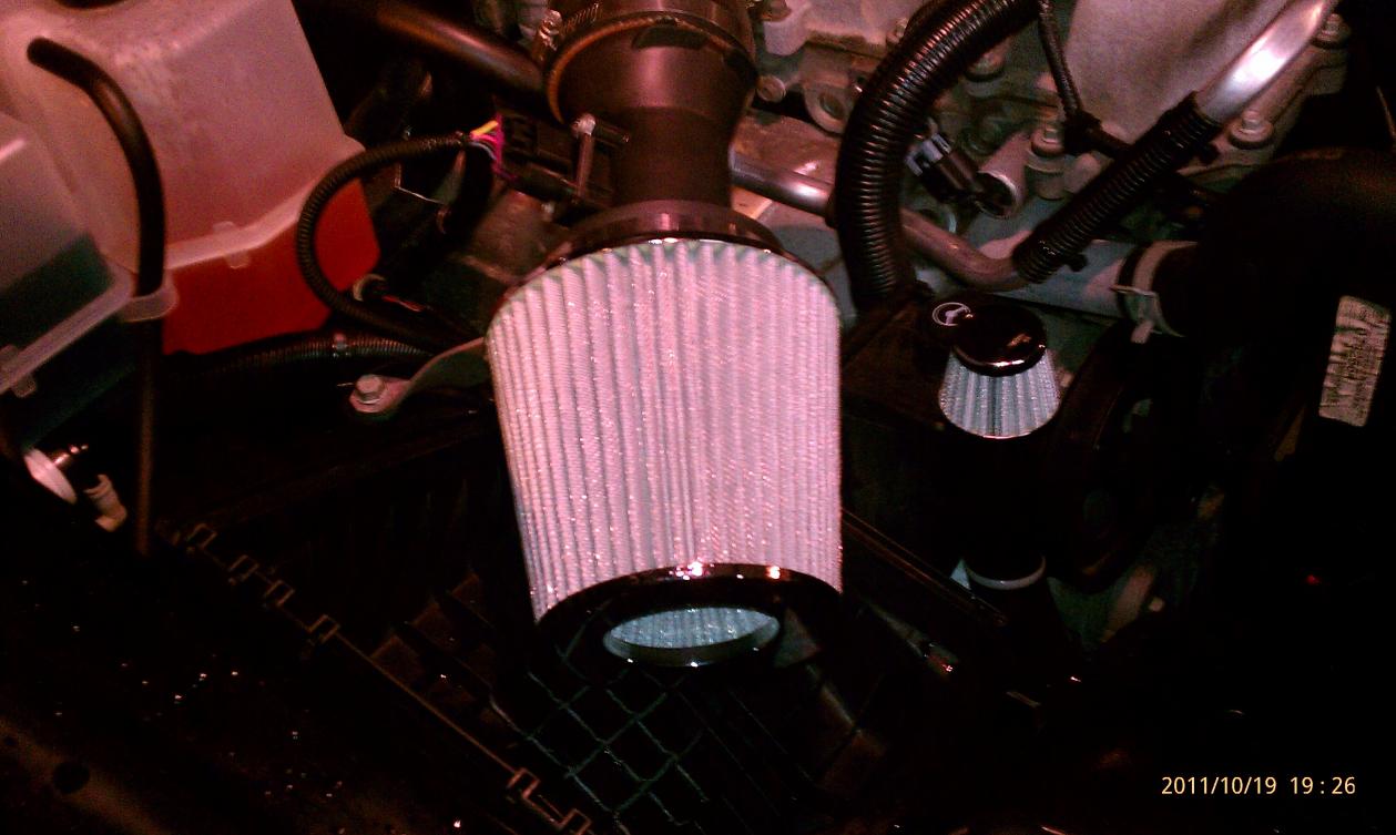

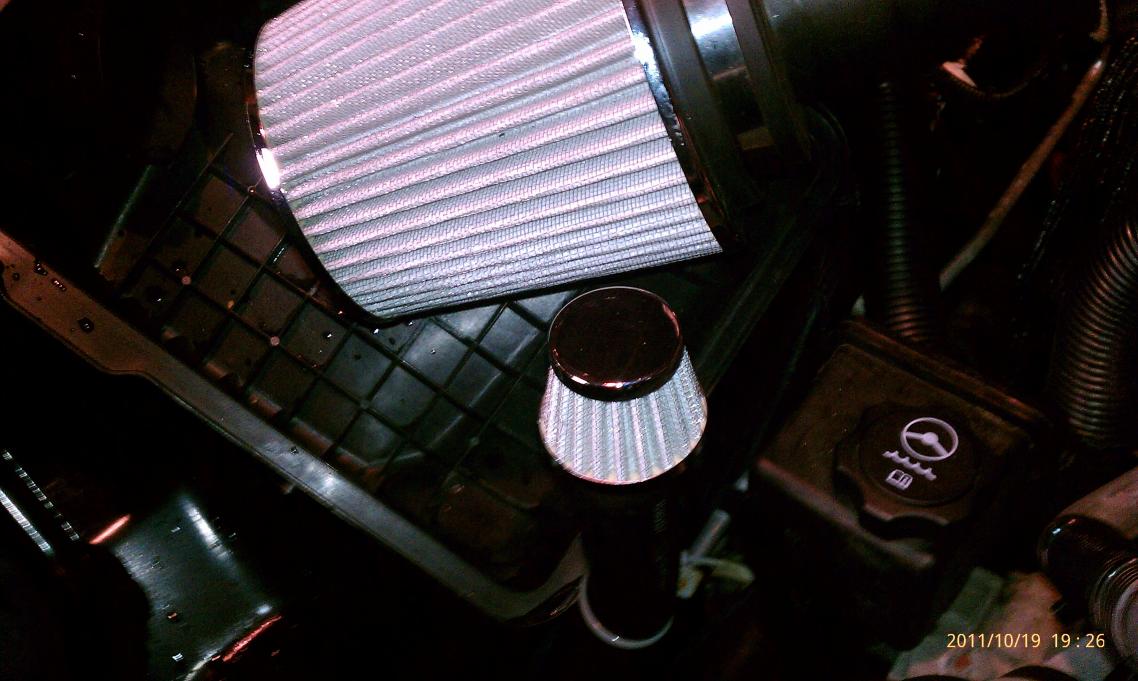

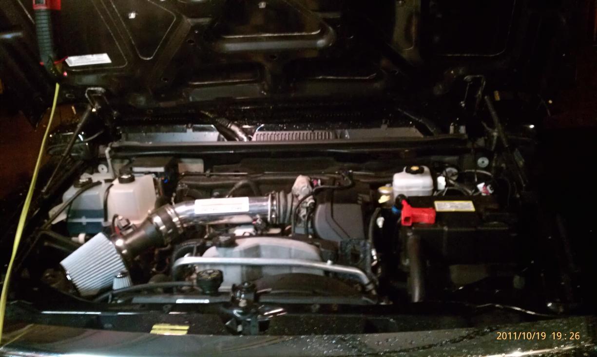

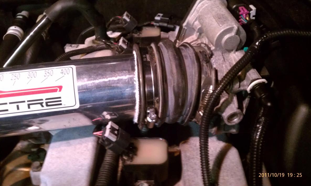

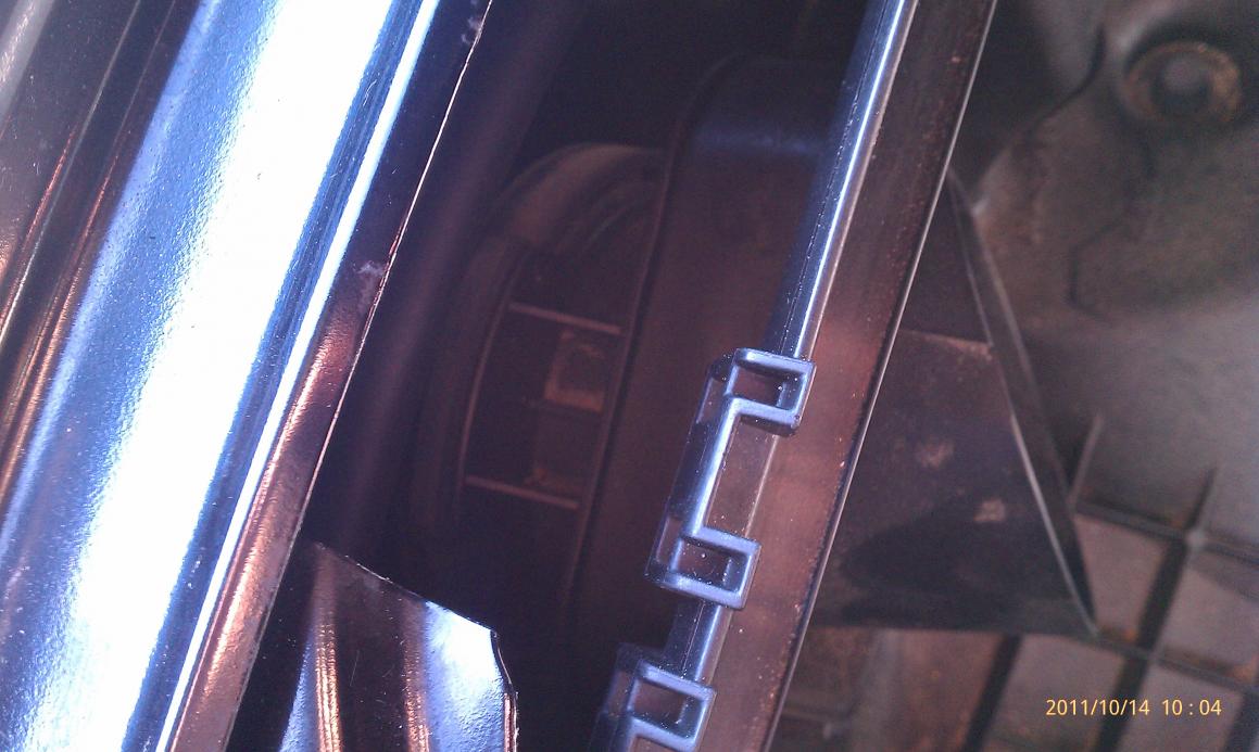

Default the $80 CAI for 2008 H3's
I put in a K&N flat panel filter, and noticed little gain in power, sound, and appearence.
I then went back to my original idea and made a custom CAI. looks to be the only CAI for a 2008 H3 on these boards ?
thanks to Earl at GRD for the help with the install !!!!
the sound is AMAZING. sounds like a Ferrari taking off. all out of the little 5 cyl.
and definately noticed a pick up in power. has a nice little kick just like the v8 alpha does at first throtle as well as around 50-60 mph.
nice.
Attached Thumbnails The Under  Air Intake!-intake-1.jpg   The Under  Air Intake!-intake-3.jpg   The Under  Air Intake!-intake-4.jpg   The Under  Air Intake!-intake-5.jpg   The Under  Air Intake!-intake-6.jpg

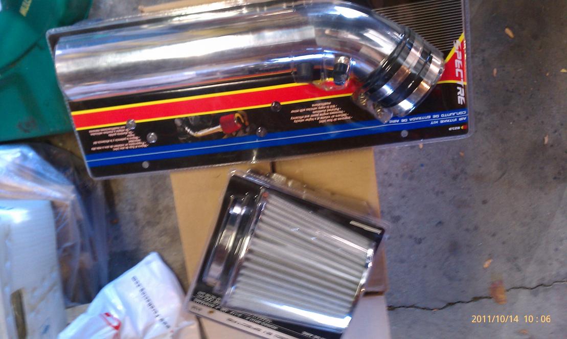

here are the rest of the pics of the CAI setup.
Attached Thumbnails The Under  Air Intake!-intake-7.jpg   The Under  Air Intake!-intake-8.jpg   The Under  Air Intake!-intake-9.jpg   The Under  Air Intake!-intake-10.jpg

the CEL came on and the code was P0411, secondary air intake issue. I am guessing it is the small filter i put on the air pump hose. The filter diameter was much smaller than the hose, so maybe the air pump is not getting as much air ? should i remove the filter and just put like a screen on the hose ? (hose in front of the air box going to the air pump.
? i did check the fuses and hose connections everywhere, and obviously with this code, it has nothing to do with the air intake at all.
suggestions ?
suggestions ?
how exactly do you figure 'it has nothing to do with the intake at all?'
You chopped the intake up then you get codes that you think have nothing to with it at all?
hmmm 1+1 = uhm wait a minute I need my calculator...
