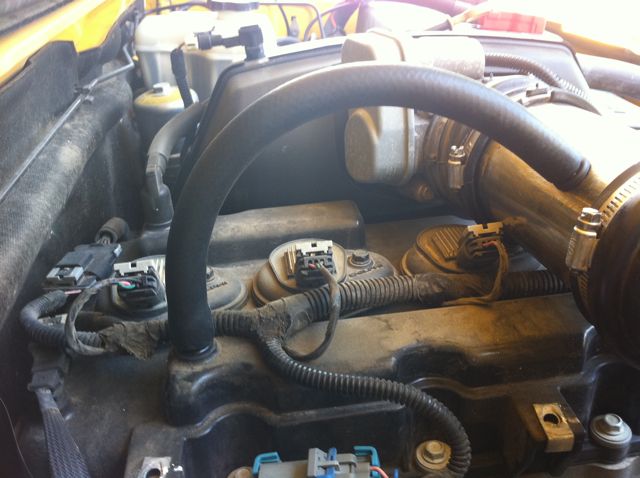

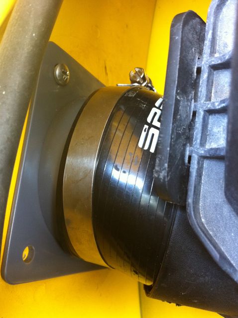

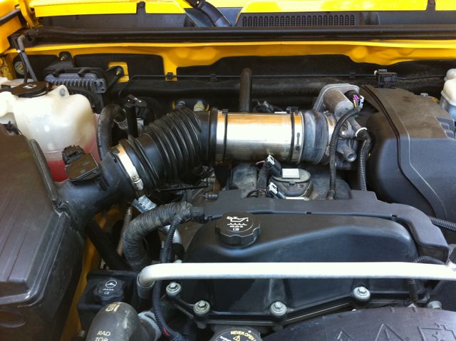

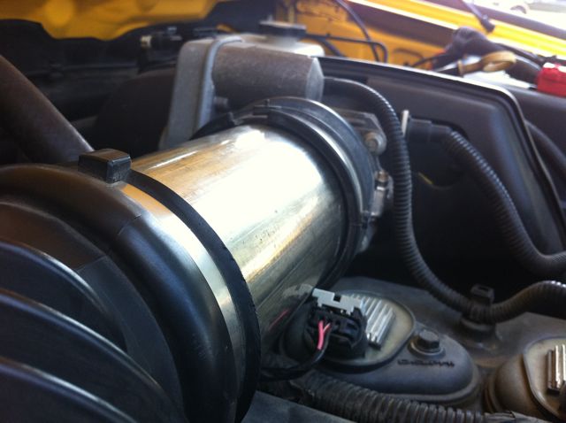

I also started the mod with the flange and adapter to the air intake and was thinking, since everybody was getting adapters to go from 3 1/2" to 3" pipe what would happen with a 3 1/2" pipe. Then wandered through a muffler shop and asked if they had an old piece of 3 1/2" exhaust pipe about 6 1/2" long I could buy or have. They said sure so here is a couple pics of the finished product with free piece of pipe. Fits like it wanted to be there. Looks like injectors touching but about 1/16" clearance front and rear. Please don't pay attention to the dirty engine top as this part was hiding. I also put the clamp on the flange at the fender just as a precaution so I could sink the rubber coupling deeper into the intake.
Attached Thumbnails The Under  Air Intake!-airpipeback.jpg   The Under  Air Intake!-airpipefrt.jpg   The Under  Air Intake!-frtview.jpg   The Under  Air Intake!-intakeflange.jpg

looks very direct,nice from front. why the "big"hose compared to the original.
does that measure 3.5 on the outside?
