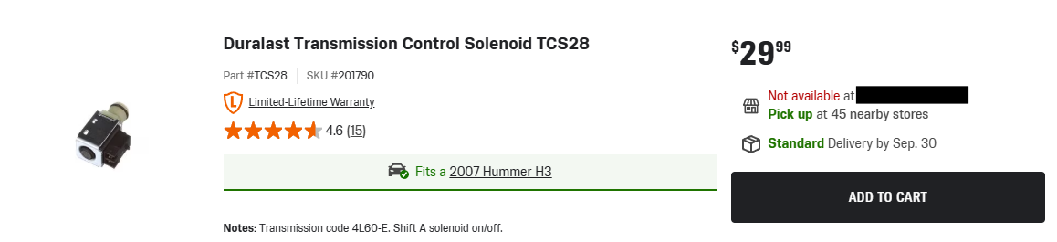

Part was $30 from AutoZone, but note that it does NOT come up on their computer under Hummer. Ask for SKU 201790 - picture below.

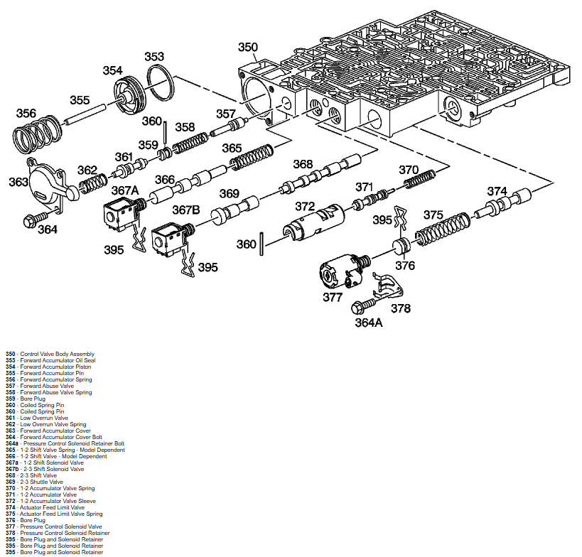

Valve body diagram below. 1-2 shift valve is 366 and the solenoid is 367A. You can see how it is held in with the clip. This is all accessible by dropping the pan - you do not need to remove anything else.
