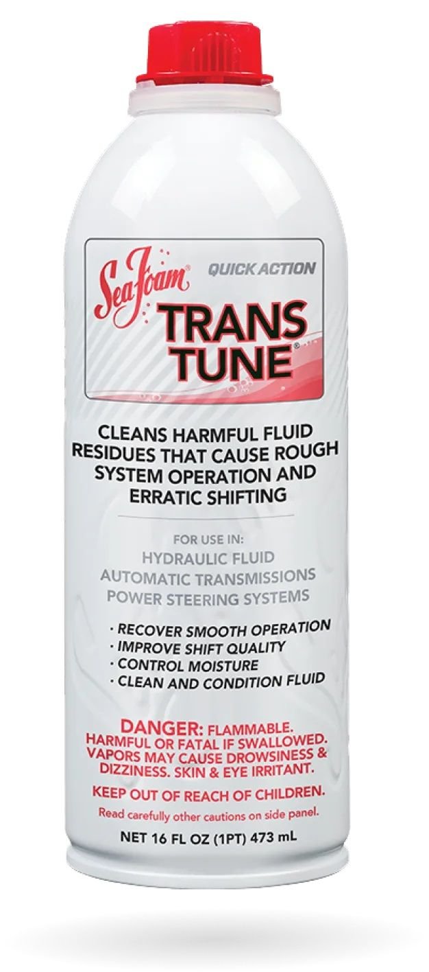

Open up a can of Whoopass>>>>>TRANS-TUNE TRUSTED BY MECHANICS SINCE 1942
Also check fluid level(at operating temp running) & color.
