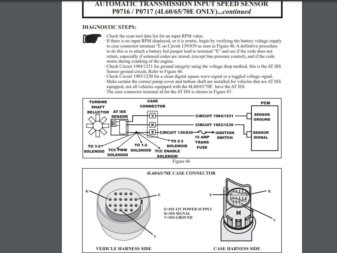

IT IS H3 BASE MODEL with 4L60e transmission. brand new ecu installed. it does give a code #0717 input speed sensor . but i just had the transmission rebuilt.
is this the sensor inside the transmission? could it be a bad ground ? do i have to remove the transmission again to fix this? please help. ive spent over $2000 and i still can not drive

You have a broken cable. Everything is written in the manual. Good luck.
above posted the answer to your question
