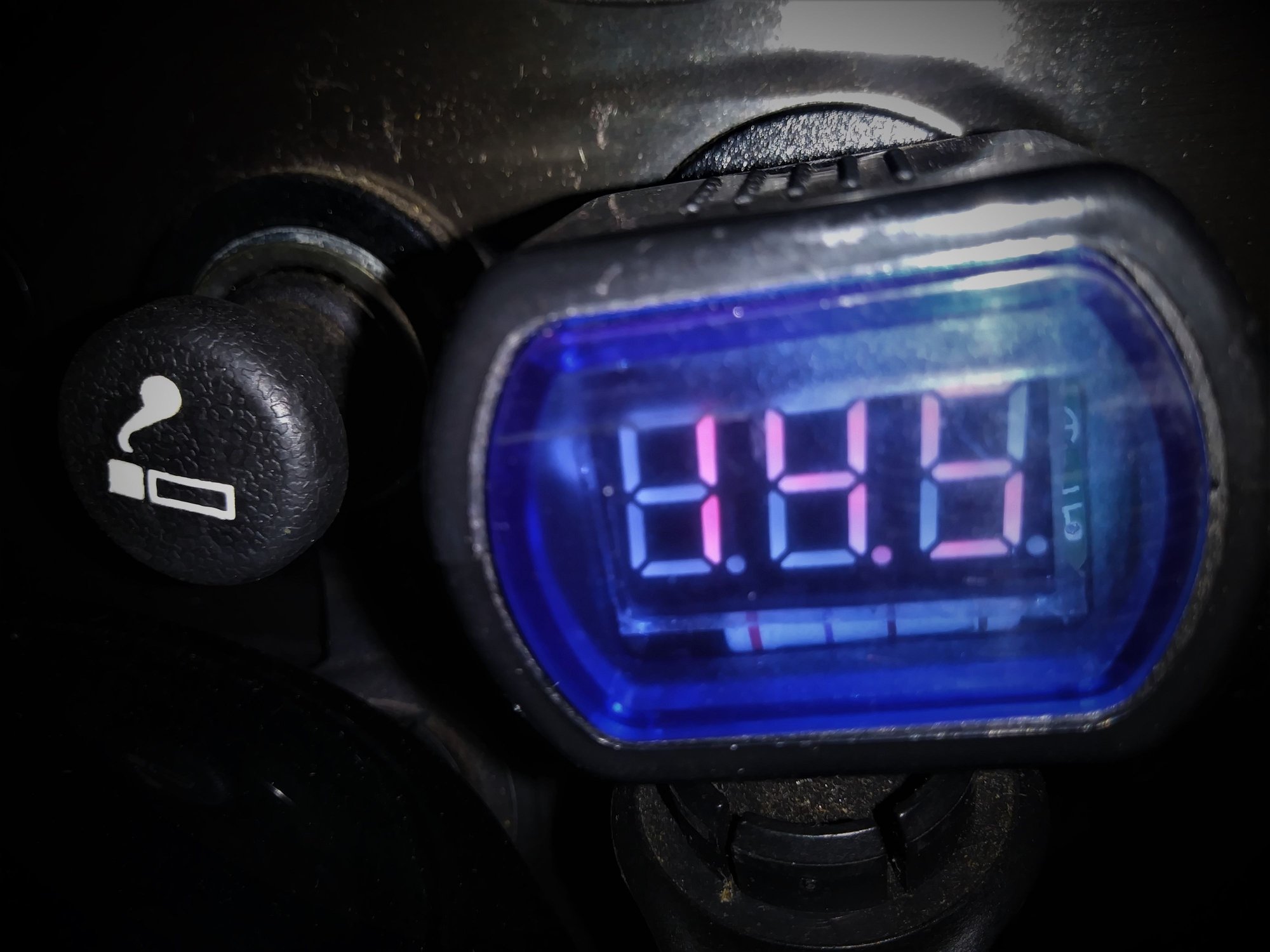

Min. 14.0v. I just checked mine with all accessories on at idle, tested with aux outlet gauge:
With only the drl lights on I get 14.5v(camera flash hard to see leds)

Originally Posted by Alibou
Bcm+alternator charge only when solicited by the battery to not overcharge it
Explain how your "bubble gum machine" scan gauge controls the voltage regulator?
