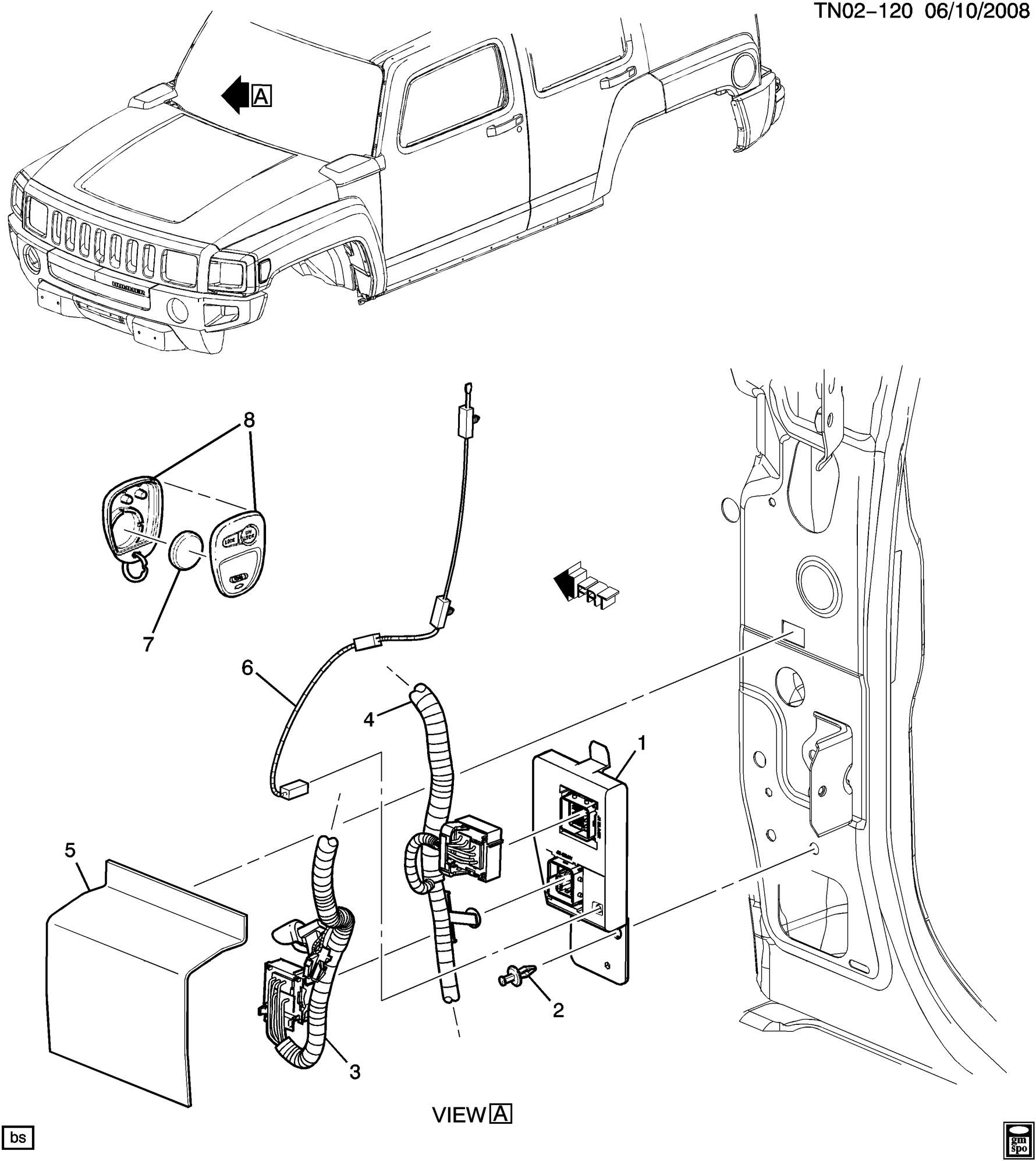

Not blowing smoke on this 1, personal experience on my 3 happened after I washed the BCM board and connector contacts. I don't lock my 3 unless I'm out with tools inside, I stopped at the HD and grabbed my fob from the center console, shut the door, and the fob didn't respond. No problem, lock with the key in the driver's door. After a couple weeks, I went back to the BCM and found my antenna disconnected, reconnected and fob works again. The whole time driving I NEVER received>> LOW TIRE nor SERV TPMS!

Fuel fill pocket is slightly different in diameter, yet the fuel door & trim covers it.
Very different diameter, depth and angle... but yeah it's the same... he could start an argument in an empty house
Or maybe the TPMS doesn't even use the same antenna wire, but rather an internal antenna on the BCM? It's quite possible that the TPMS was in fact still working when your antenna was unplugged, but because your tires weren't low and the sensor batteries were OK, it gave no DIC messages.
