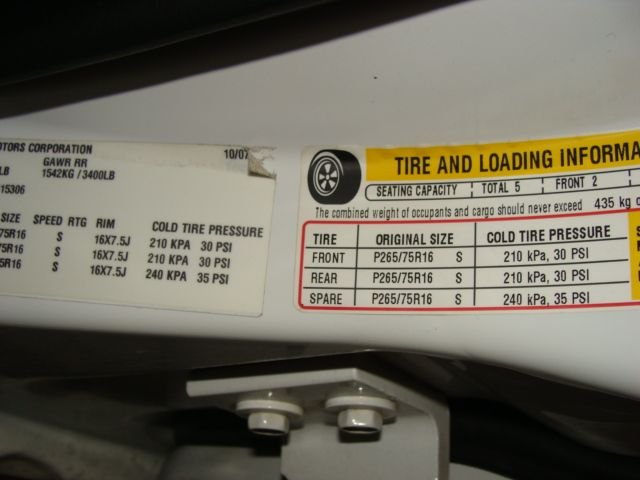

We both have '08 Alphas so the difference is you have the offroad package and I don't. That would make sense that you're 'LOW TIRE' light would come on at a higher P.S.I. then mine, as we have different recommended P.S.I. and thus, different TPMS.

BTW, not all H3's show 30psi.

The pic of my door sticker was not about you, it was pointing out to the OP that the H3s with 285s recommend a different pressure. 30psi seemed low to me for a 5,000lb truck, and I stated that I was going to look at mine. All stickers everywhere, not just H3s, say "Cold Tire Pressure". Duh; common knowledge. You treat people like they're all idiots, and it's not attractive. I'll bet you're a riot at parties.
For the OP; since you are running significantly larger tires than stock, your sticker's PSI numbers really don't apply anymore, so bumping the pressure up to 38+ is the solution to your problem, and should eliminate the LOW TIRE message.
