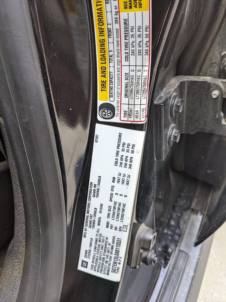

Which is exactly what I said, isn't it? Low tire = LOW TIRE message. ECM not receiving a signal (that could mean dead sensor battery OR disconnected antenna) = SERV TPM message. Which is what the owner manual states. You claimed that disconnecting the antenna would NOT result in the SERV TPM message (post #19). Now you claim that it will (post #27). I swear, Hummerz, sometimes I think you post just to stir the pot.
BTW, not all H3's show 30psi. H3s with 285 tires call for 35psi. Here's my door tag:
If my pressure drops below 34-35psi, the TPMS alerts me to a low tire; EVERY time, and would often alert first thing in the morning when cold out (till the tires warmed up) Running them at 38 stopped the issue completely (thanks, Doc), and now my 305/70-16 BFGs are happier at 40psi.
