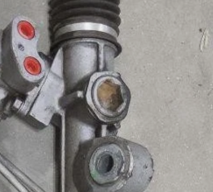

I'm looking to rebuild my steering rack on my '06 H3. I've purchase a seal rebuild kit and the bushings. My question is, what tool is needed to remove what looks like an inverted HEX bolt? I'm not even sure what it's called?
Anyone ever removed one of these?
Thanks in advance.

To answer your question, you need a hex wrench/bit. But that has an outer hex also - do you know if it is part of the plug or part of the rack?

maybe you can find a cast iron plumbing cap plug at a hardware store that fits maybe wit a bit of grinding on the faces then either weld a bar to it or put the plug in a vise and spin the rack.
