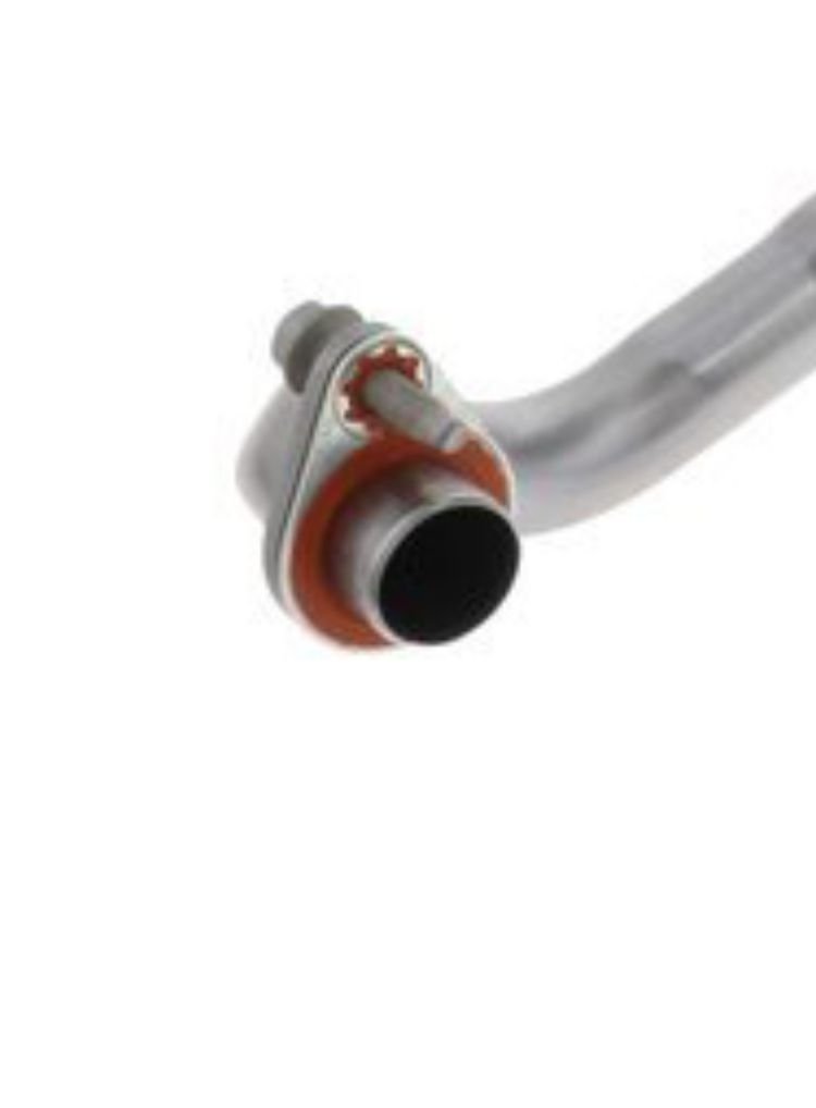

Were you having this problem before you did your engine rebuild, or did it only start occurring afterwards?
When you installed the second oil pickup tube, did you remove the old gasket that sits between the oil tube and the engine block and install a new gasket?
Was the second oil pickup tube you installed brand new, or used?
If there is no gasket between the pickup tube and the engine block, or if you didn’t remove the old one and say now there are two gaskets sitting between the the engine block and the pickup tube, then there could be a leak which is causing the oil pump to suck up air.
Lastly, how old is the pump itself? Was it replaced at the rebuild? If so, what brand?
Here is a view of the pickup tube gasket.

it occurred after few days from the engine build, and the tube was clogged with all kind of stuff that flushed from the engine. As for the new tube is brand new with new gasket . And yes I removed the old gasket and cleaned under it
I replaced the pump around 10/2023 and I got SKP
