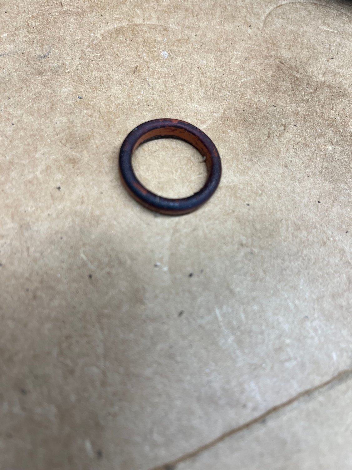

2006 H2 180k approx.
First off exhaust broken studs fixed years back (will also give tick at start up).
So, on to symptoms: engine tick at start up for 10 seconds or so (obviously +/- in your case) possibly “Low oil pressure” warning at start up or delayed showing pressure in gauge momentarily at start up.

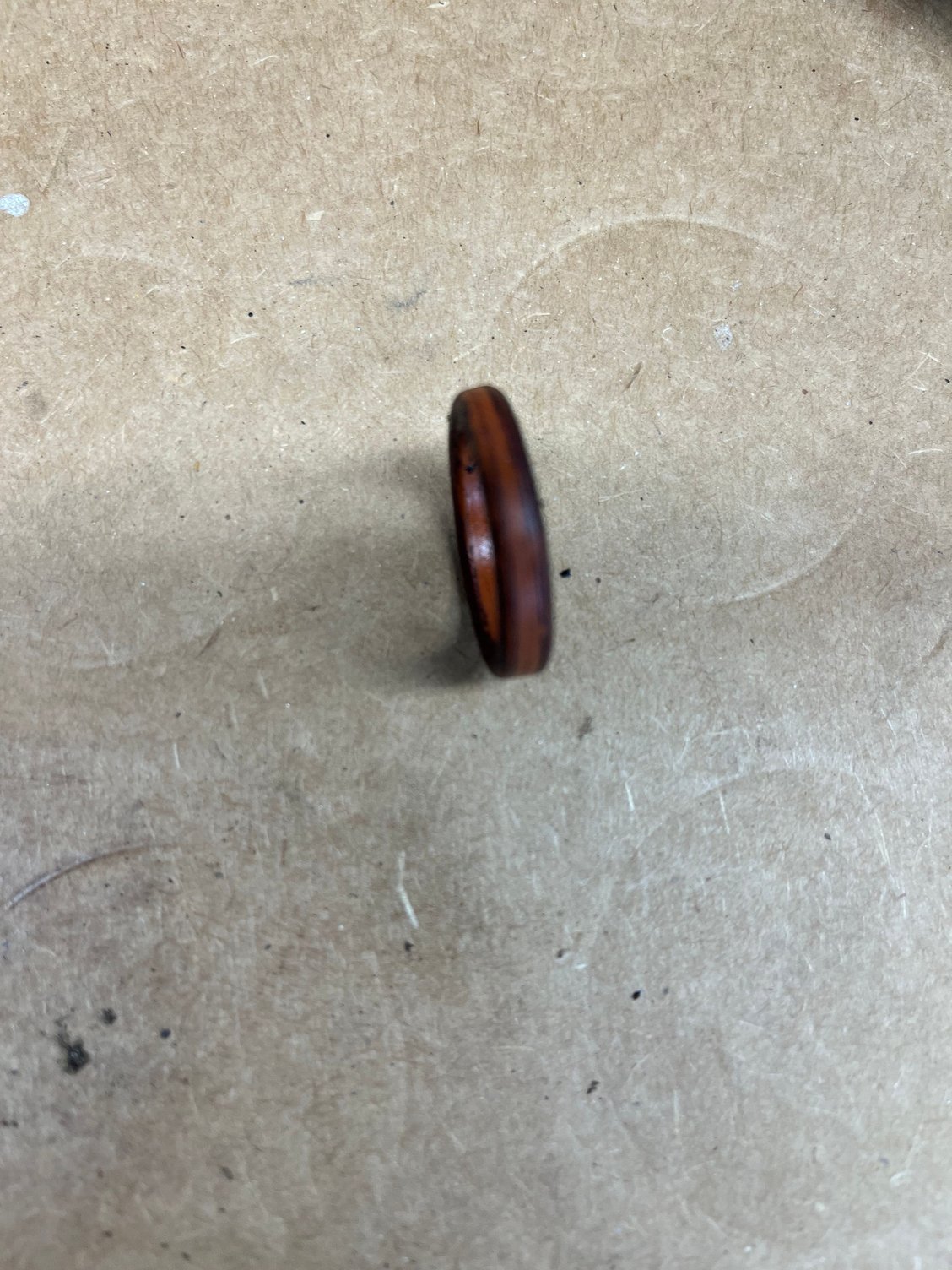

Cause: Oil pickup tube o-ring is “flattened” and causing loss of suction at start up.
See attached pics, you could clearly see the oring was “flattened”. How many orings can you stand on its side and get a picture, lol.
oil pan needs to come off and 3 bolts for oil pickup tube removal. So, hours of labor to get a few dollar part replaced. If your doing this and you have external oil leaks already- you may want to do the front engine cover/front crankseal at same time since the sealing surface at oil pan is going to be removed anyway…with 20 years +/- on the original seal and gaskets- now is the time. Also your oil cooler lines and the seals for them. The front differential just needs to be unbolted and if you follow another post on this site- you don’t have to totally remove it, will drop enough with persuasion, unsure about 08/09).
Upon start up - pressure now instantly shows, no tick AT ALL, even if sitting for weeks!! Highly advise you do this, that oring is not going to fix itself and condition will continue to deteriorate. Plus you may stop many sources of external leaks you may presently have….
Hope this helps someone thinking they may have a serious engine issue and it can be as simple as this……
