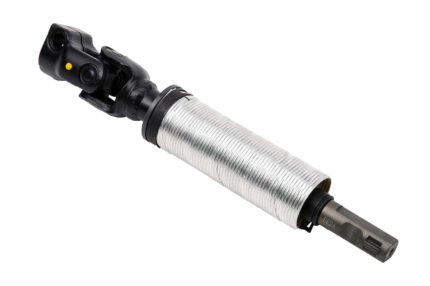

If your issue is play in the steering wheel, it's most likely NOT your rack.
I would go ahead and order these (actually, I did for the play I have in my wheel):
Amazon Amazon
and the lower shaft (3.5/3.7):
Amazon Amazon
5.3:
https://www.gmpartsgiant.com/parts/g...)&location=pd:,

I think the only difference between the 3.5/3.7 and the 5.3 is the 5.3 has the heat shield.

Old Feb 2, 2024 | 06:48 PM
Originally Posted by Tony-Nav
Note* the steering wheel play isn’t bad but it is noticeable enough to cause alarm on slippery and snow roadways. Whichever happens, I will inspect the wheel bearings also just for S&G’s.
While under, inspect the> STEERING SHAFTS! & check tire tread depth:
