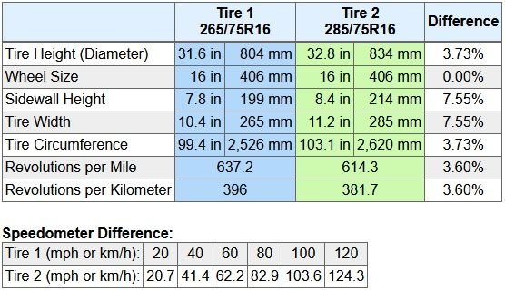

20? What size tires mounted?

Lt285/70r

P.S. The chart doesn’t account for a 20mph difference. When my speedometer reads 10mph I’m actually doing 30mph. 30mph is actually 50mph

70r-WHAT:size wheel?

17” wheels
