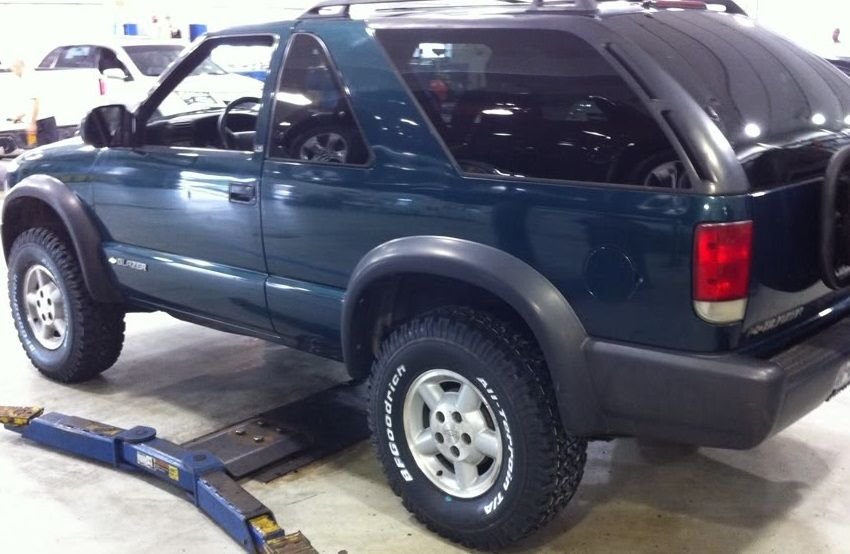

Best to go bigger, reduces stress on the odo. When I purchased my '98 Blazer(2000) it had 205's on it (4wdZR2)? Took it to my shop and installed 31/10.5's. Daily driver and took many multi states road vacations with the family. I sold it in '12 with under 50k miles on it, NEVER tampered with the odometer. The buyer was impressed after a 1hr TEST drive, gave me well over KBB/NADA.

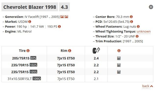

Great story, but I find the "facts" to be askew.
If that is a photo of the 98 Blazer you speak of it IS a Zr2 and came from the factory with 31X10.5/15LT.
So you putting on
31/10.5's as you stated would have done nothing to the speedo or odometer because that is what it was set up for stock.
Even if it wasn't a ZR2, ALL 4x4 98 Blazers came with P235/70R15 tires. Significantly larger than the 205s you posted.

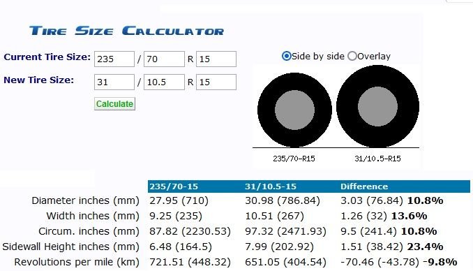

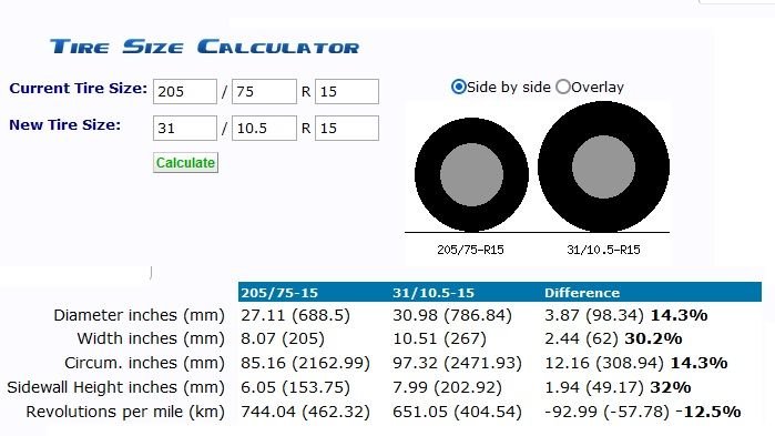

So you putting on
2dr came with 205's too. I purchased a dealer demo with low miles, my buddy worked there and let me know it was available to me cheap($15k/msrp$25k). Dealer swapped tires for demo(oem 235's)
You are correct about size to speedometer/odometer programmed, except the fact that if I kept driving on the tires that I purchased it with, the odometer reading would have been higher when I sold it. I bought a 2dr/4wd/off road suspension/emerald green blazer as is, since price was low and I worked at a tire shop(installed new tires, sold the used tires)
Still a huge variance from stock to 31's:
