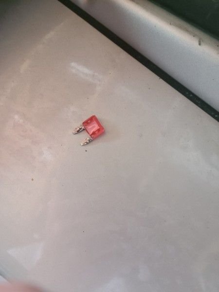

My H3 would only start occasionally and would stall after coming to a stop. The ABS warning, traction control warning, and many other flashing lights were present on the dash. The brakes locked themselves up, the gauges stopped working, I was getting odd battery voltages, the brake-lights would not shut off, and I could not figure out what was wrong!
After a couple days had passed, I decided to triple check the fuses and discovered my problem. The blades of the fuse (not the filament) for the BCM were corroded and had arching and scorching marks. This was a great clue, so I sanded down the blades, replaced the fuse, reconnected the battery, and the H3 started right up! I drove around for 20 minutes while stopping, starting, turning it on and off, and traveling on uneven terrain to ensure it was not "a coincidence." I was convinced it was related to the common pass-lock or BCM problems, but it ended up being a simple $0.05 (or free) repair!
I hope this can be of help to others who might experience this problem in the future. Here is a photo of the fuse causing my problem:

What number fuse is the fuse for the BCM ?

On the underside of the fuse panel cover it shows the number for BCM (#14).
