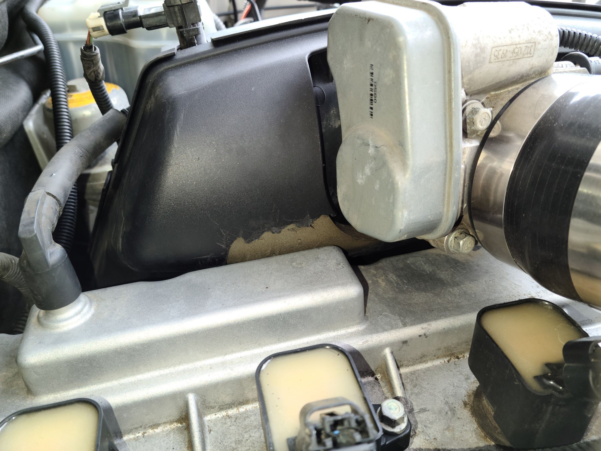

There's a big chunk of material missing from the outside layer of the intake manifold. It looks like maybe someone tried prying it off or something. I sprayed a decent amount of starting fluid at it with the engine running and the engine didn't move from idle at all.

Whatever, paint if you don't like the look. Did you have the P0171 before you pressure washed the engine?

Okay, cool. I wasn't sure if the cracking was important or not haha. I'll just leave it. It's hard to see, anyway.

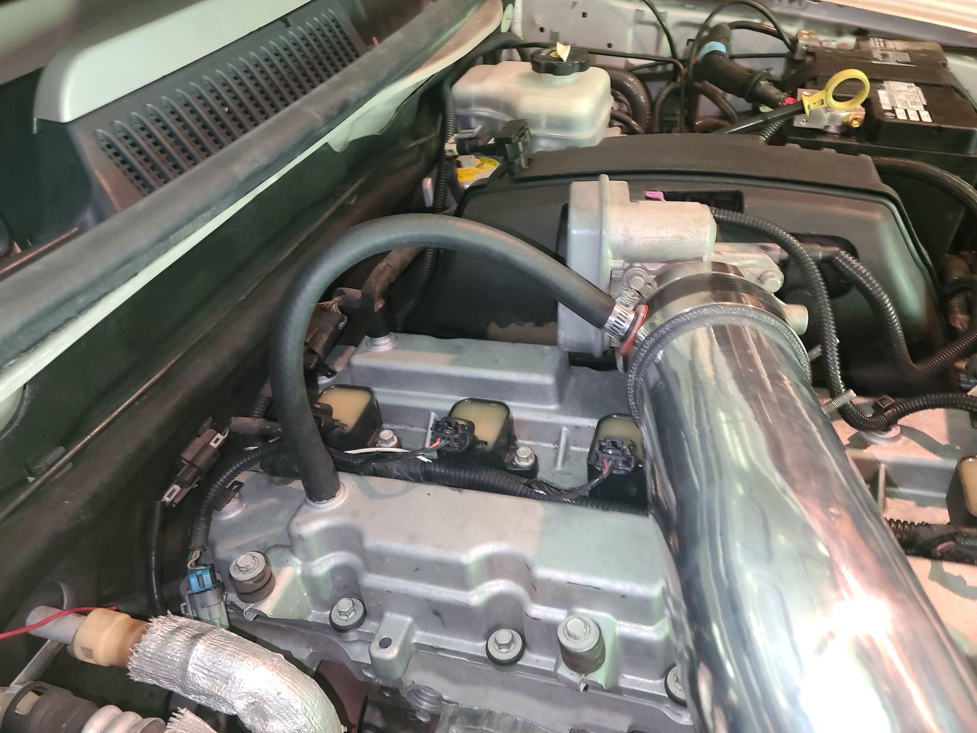

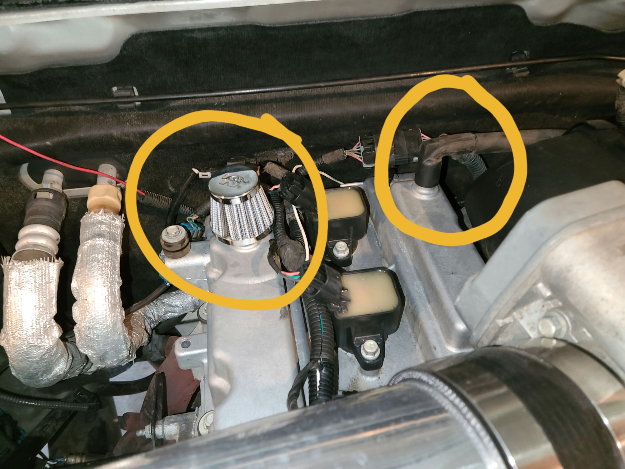

Here are the two spots. Is it sucking on the right line so the left filter (old hose) is pulling in air?
Old May 7, 2021 | 07:07 PM
  #27
Yes there should be a port in your aftermarket cai for a hose connection? Put that on your to-do-list. In the meantime, Did you check under the cops? / Clean/seal the FI connectors?
Stick with it, you could be a Hummer MasterTech.
At idle, the manifold vacuum is high, which would draw in a large quantity of crankcase gases, causing the engine to run lean.

A high vacuum from the manifold makes sense, which would totally take in a lot of air through the breather filter instead of metered air being pulled through the intake tubing into the breather tube and back into the manifold. Thank you for painting the picture for me.
I actually made my own CAI and modeled it after a K&N kit for a 2008, which comes with the mini filter (I think). There must be a different design with the later manifolds which allow for the breather filter. I will buy a nipple and install it into my intake tubing so I can run a breather hose to it. Hopefully that'll solve this issue.

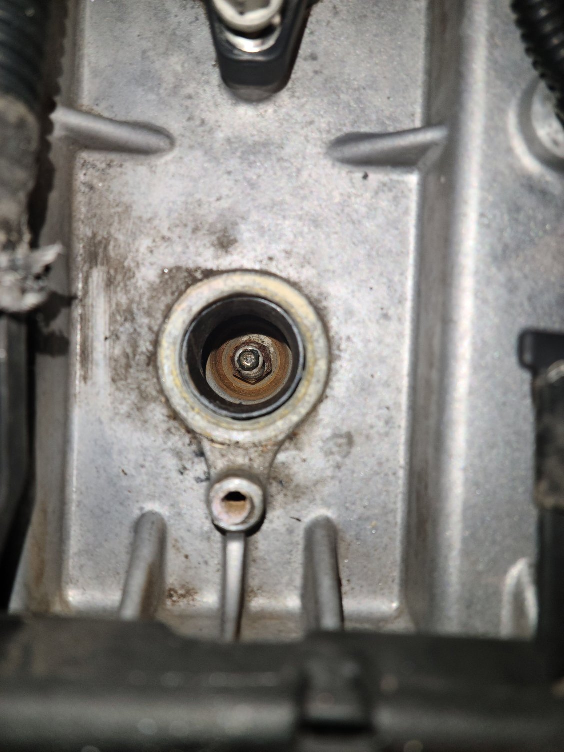

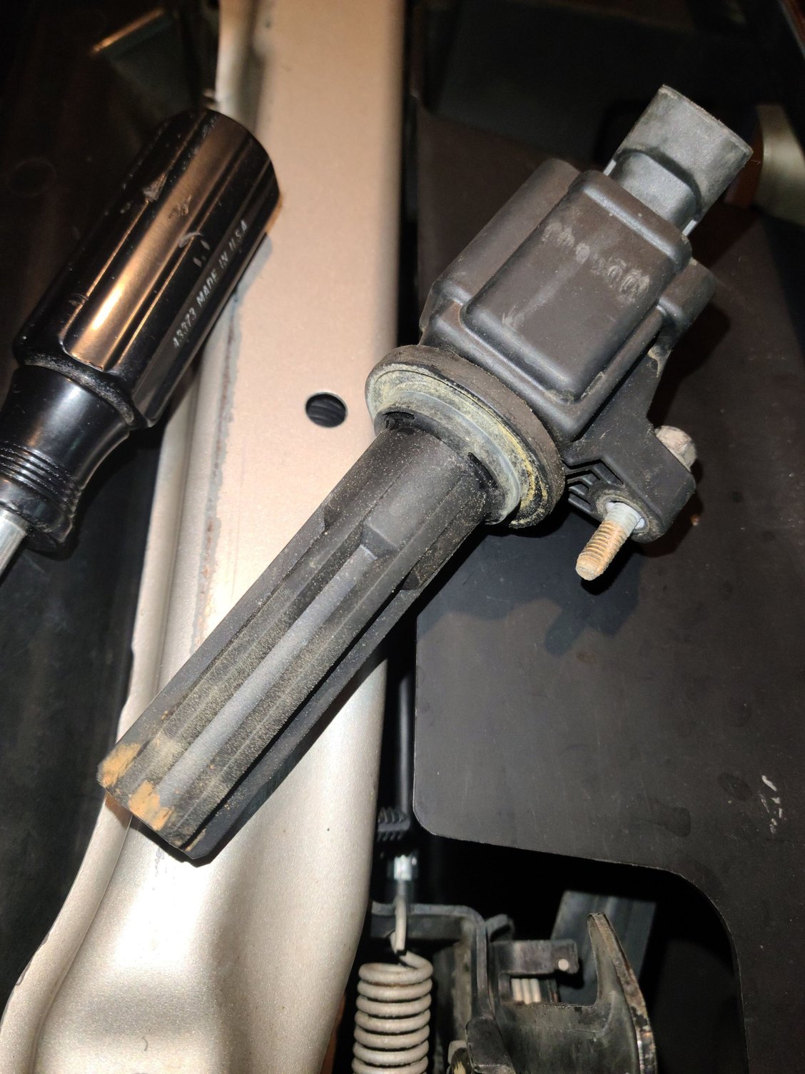

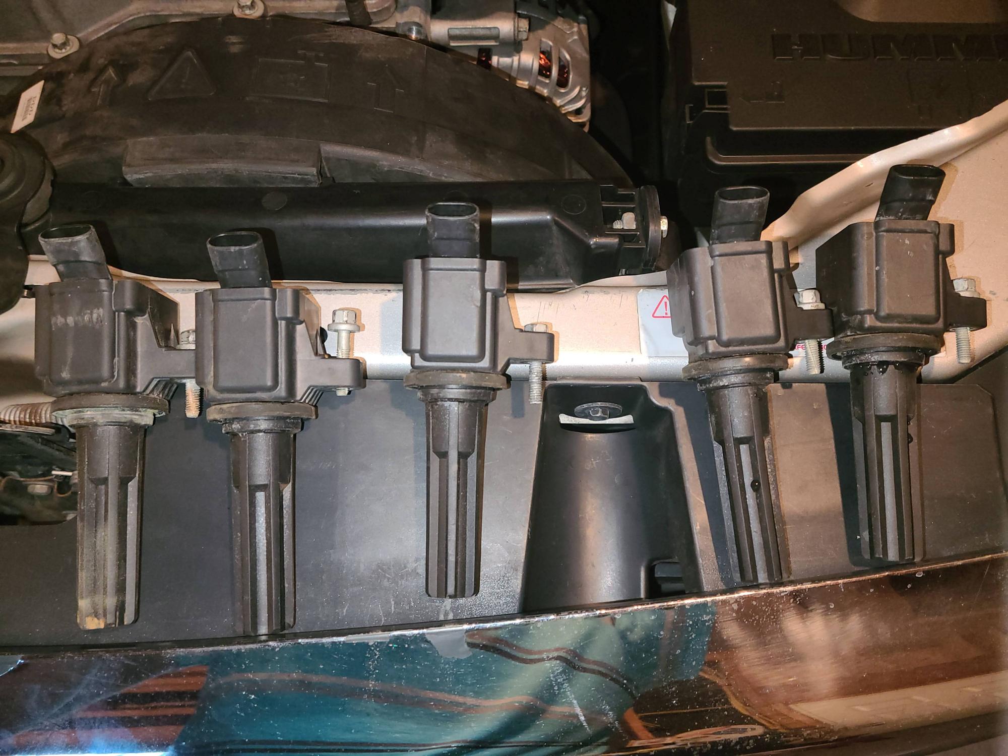

There was definitely water in the holes with the COPs. Thanks for the tip on those. The front hole has a lot of rust in it and the rest are decent looking (but still water in each).

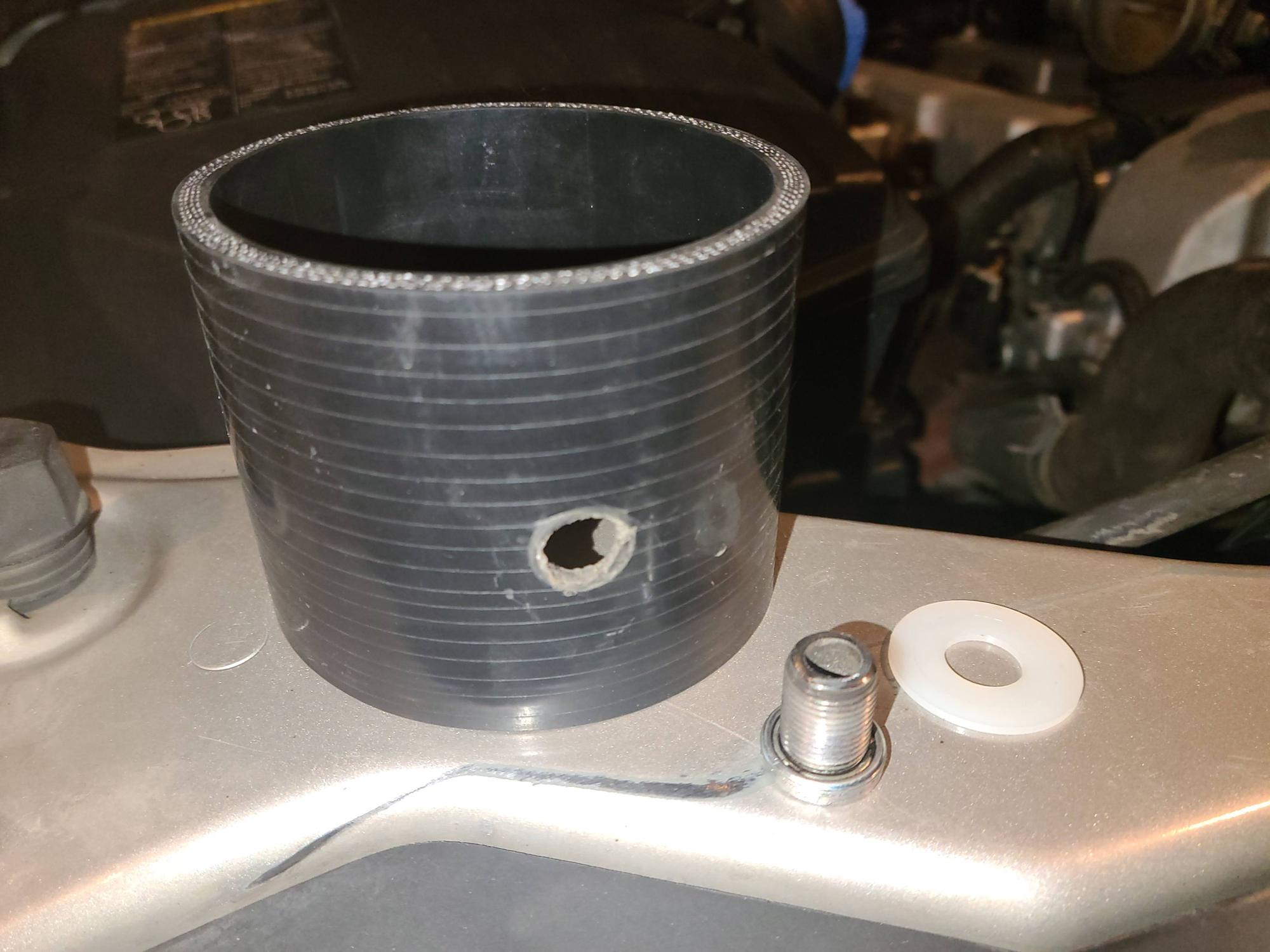

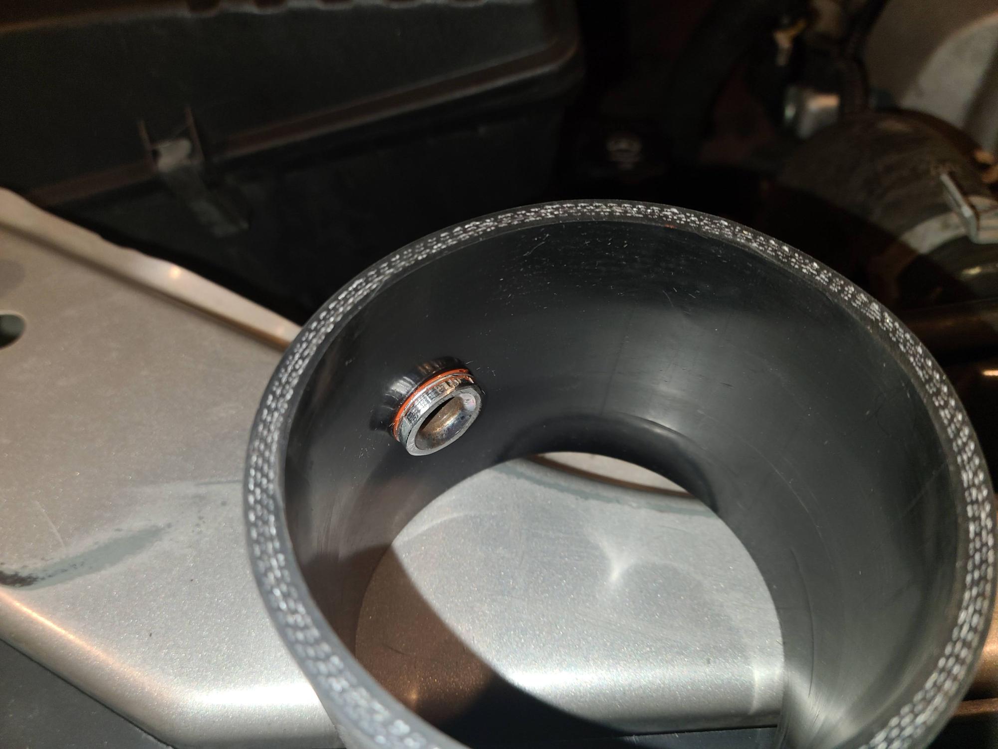

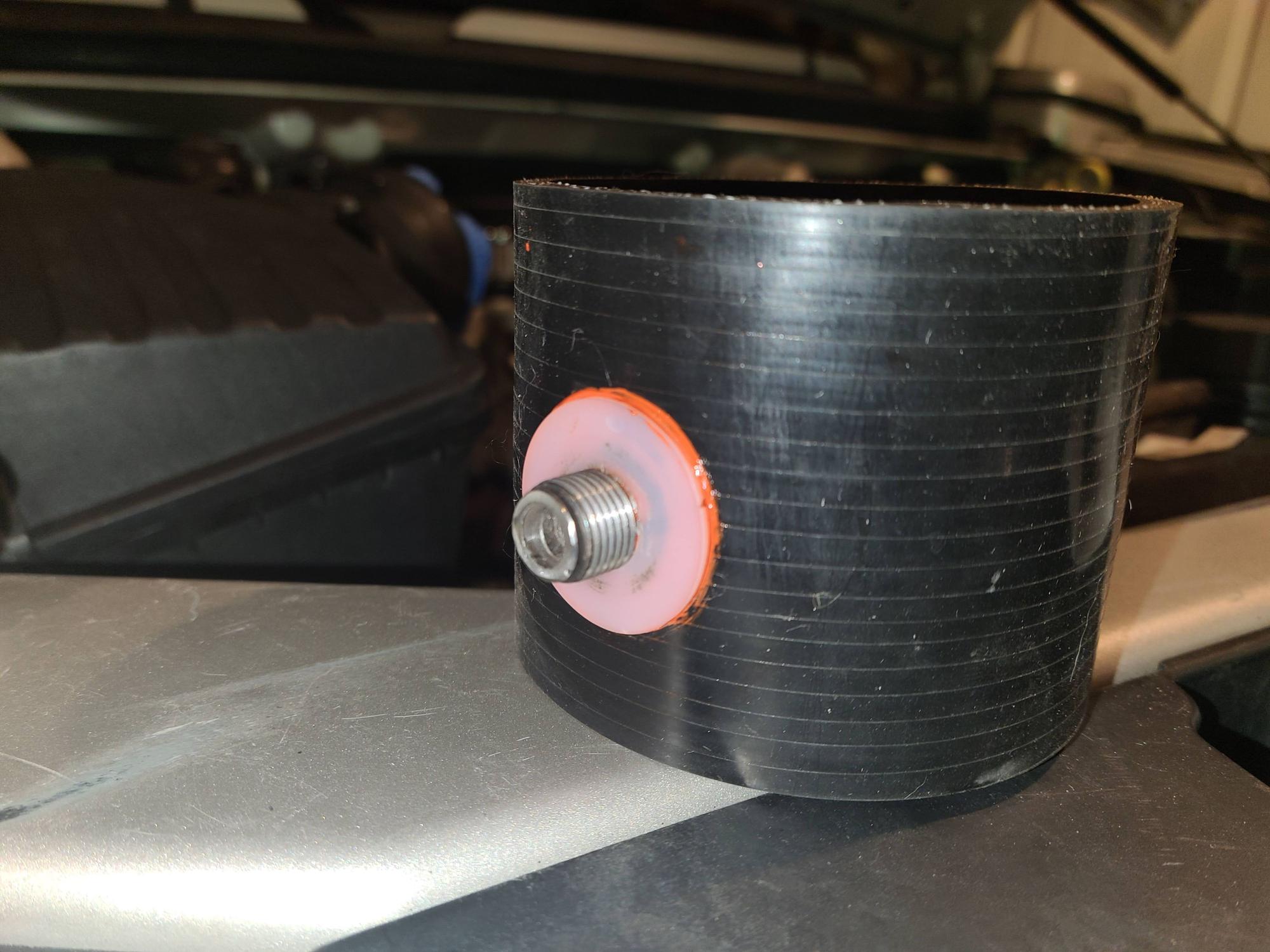

I did some barnyard craft work and solved the vacuum leak (thank you Hummerz). I cut up an old spark plug, found a tight fitting nylon washer, applied some RTV, and hammered the sandwich together on the coupler just before the throttle body. The lean code is gone and hasn't come back. Now the P0137 code is pending. I cleared the pending code and unplugged the battery. I'll see if it goes away on its own. If not, I imagine the O2 sensor is bad.
3.5-inch silicone coupler, cut up spark plug, a nylon washer, and some red RTV.
Outside view.
Inside View.
