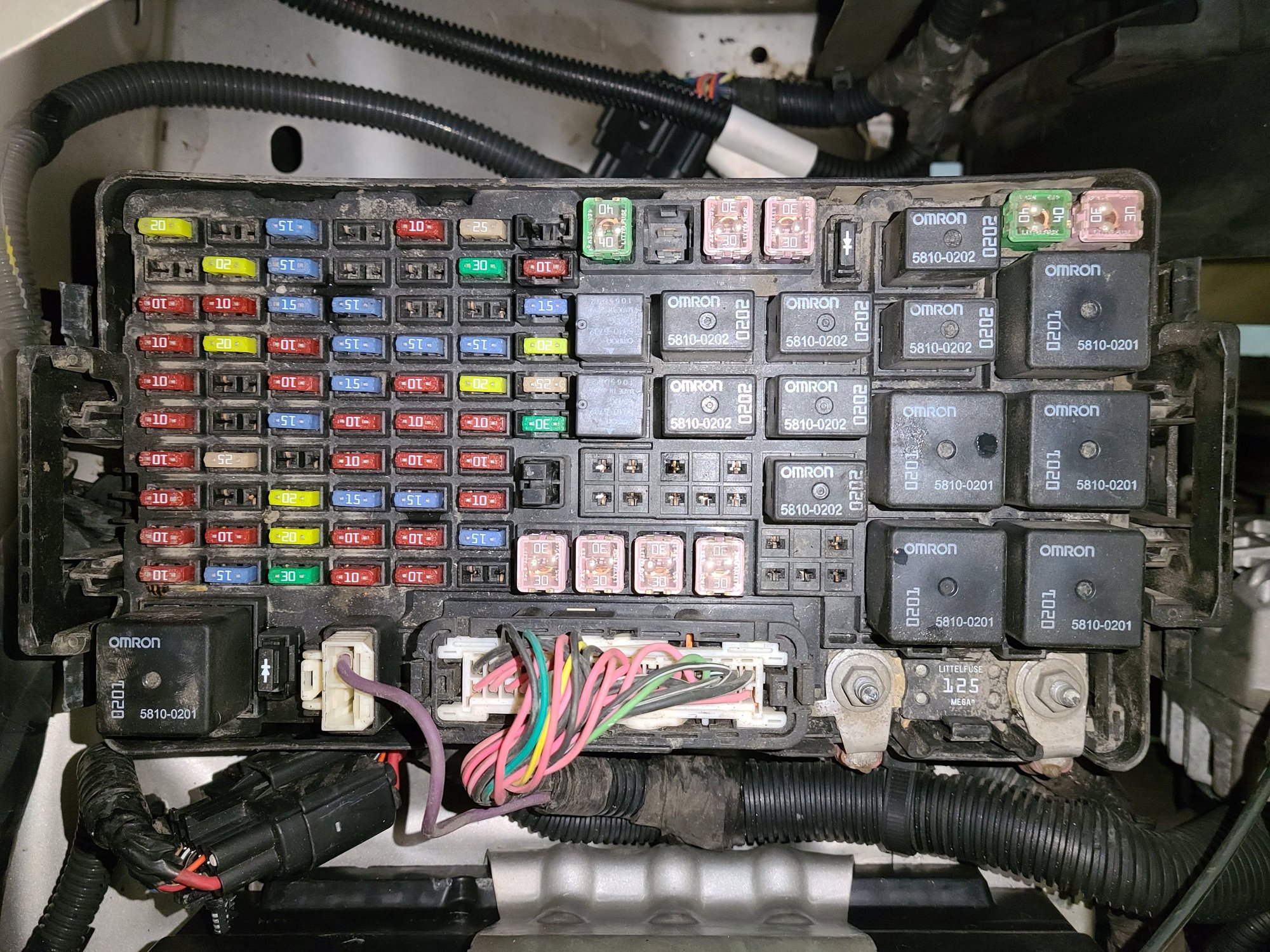

This morning I went to the car wash and got carried away in the engine bay. It looks great but won't start (properly).
Please let me know of some ideas to try out. Any advice is greatly appreciated!
Before car wash:
*no codes (pending nor ready)
*starting and running as usual
*extremely dirty engine bay
During car wash:
*blasted grime away from nearly every place imaginable with the pressure washer wand (regrettably) including under the fuse box area (with cover on) and around the PCM
After car wash:
*will not crank or start in park
*codes: P0136, P0169 (if I recall correctly)
*single ignition solenoid click in park with each turn of key to "start"
*will crank/start sporadically in park with brake pushed down and key turned to "start"
*will start in neutral
*a few drops of moisture in the fuse box

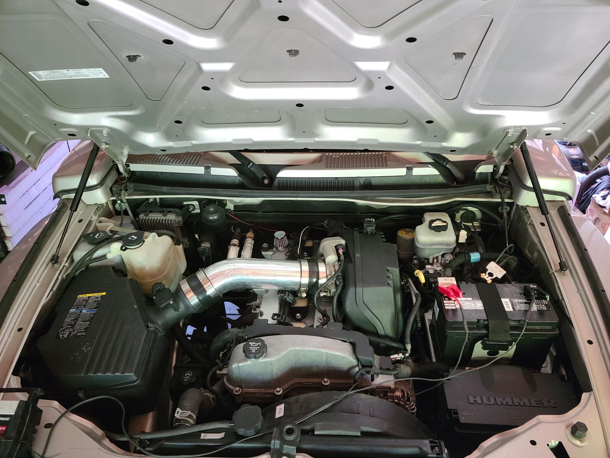

Dry it out, compressor air gun or leave hood open and wait for it. Then go to the connectors and clean/seal. Also, pull the cops, and inspect for water intrusion. Btw, check your coolant overflow tank level.

What's the ambient temp? Here it's 50's and damp, you may need to run a space heater overnight(if it's cool damp in the garage)? Best is outside with airflow on a hot day.

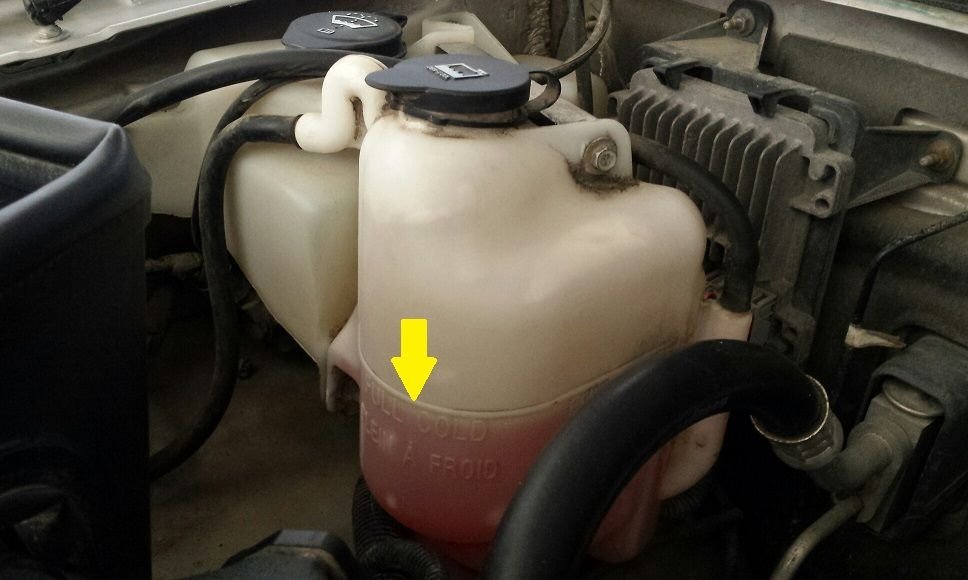

Coil On Plug(cop), pull the the bolt and inspect inside. Your coolant tank looked overfull, or may be nasty? Full should be at the tank seam. GL

It's in the high 70's and super dry here and my garage is probably in the 90's, which is helpful for my dilemma. I will be sure to check the COPs and thank you for your helpful knowledge. My coolant reservoir is actually low, but I see how it looks overfilled in the photo. It actually has blue coolant. I'll flush the coolant and fill it properly soon.
