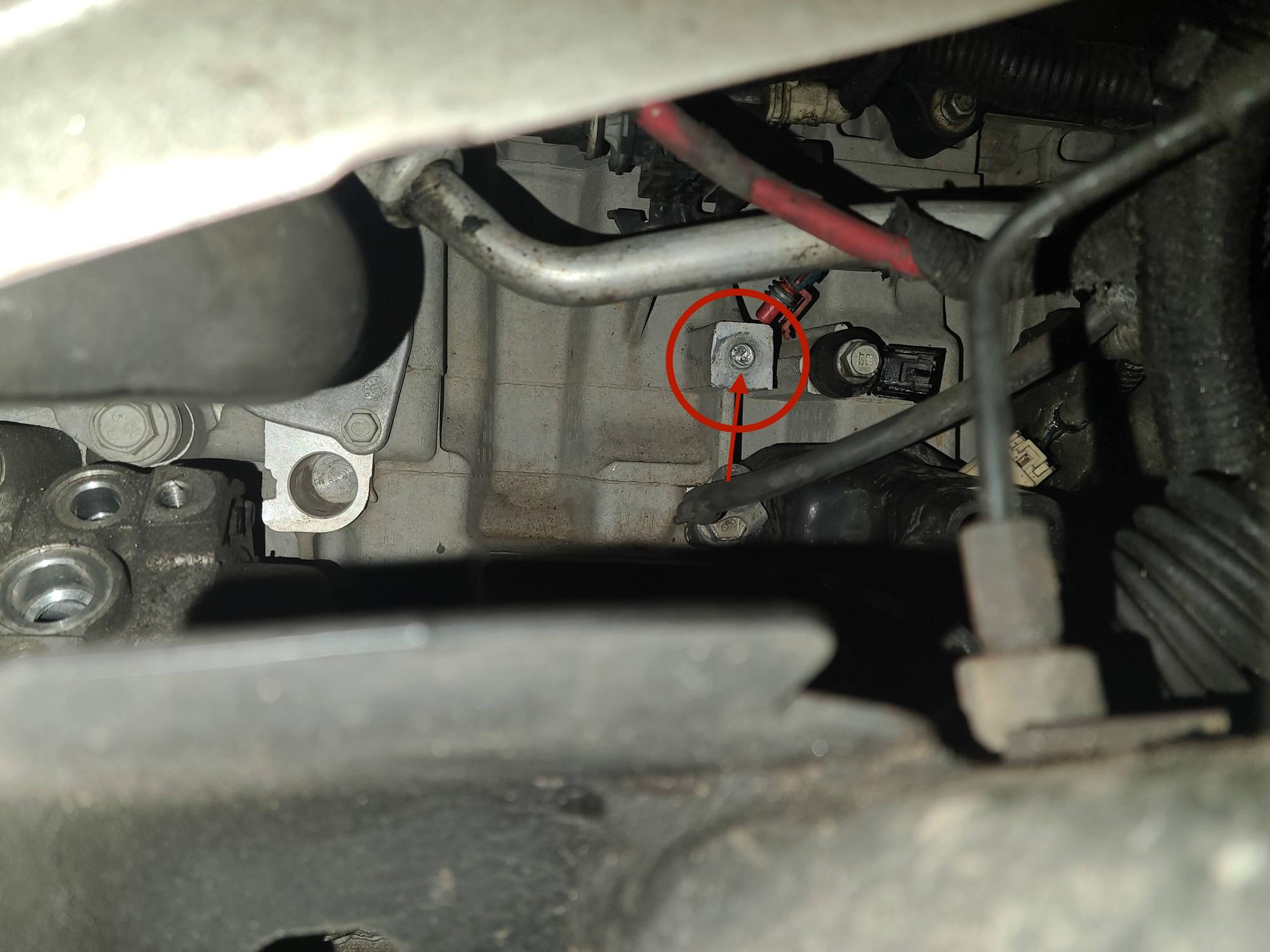

I figured I would get a start on blasting all the connectors in the engine bay with CRC and plan to grease the seals when I reconnect them all tomorrow.
I took the plastic wheel well out to have better access to some connectors on the driver's side of the engine. I gained access to a couple more connectors over there as well as a ground. Is the starter on the driver's side lower portion of the engine under the intake manifold? I see something resembling a starter solenoid and its connectors all have corrosion on them.
The ground I found (I think coming from the battery) was barely touching anything. The bolt used to fasten it to the engine must have been the wrong thread pitch and was cross threaded into the side of the engine by the previous owner (who installed the 3.7L I5). I figured the bolt would break while trying to remove it (it did end up breaking off). I'll think it over tonight on whether I'm going to drill and re-tap or if I just utilize a neighboring bolt (for the engine mount) to ground it. Let me know your suggestions.

looks like you have an unplugged knock sensor in the picture
Hey Bronx, I disconnected all the connectors I could find to blast them out. Thank you for noticing, anyway
