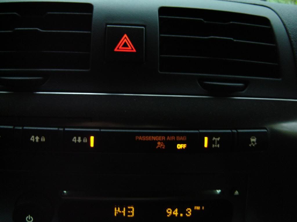

Read your owner's manual. If you had a small person under 5' tall and less than 100#, the passenger front seat, the system recognizes that and turns OFF the passenger side front airbag.
You talking about this???? In the TC Button Controls bar?

No on the panel to the left drivers side (This is the panel where the check engine lights appear seatbelts etc) The seatbelt light came on with the red ball in lap It did not clear with my wife in the passenger seat while driving
The next day I sat in the passenger seat and this light did not appear while parked
Will try again today when we take a ride and see if it re appears
