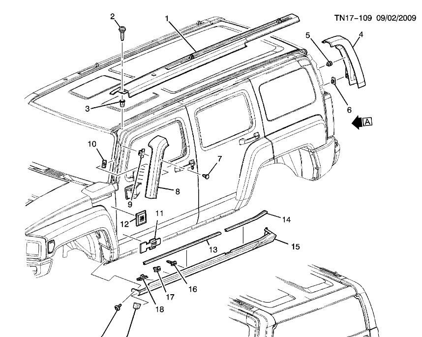

I have taken out all the torx bolts but the plastic and rail does not lift up. What am I missing? Are there clips that hold the plastic down? Thanks

7 torx bolts, someone may have used silicone on the rails to hole them down due to a leak or previous accident repair.
