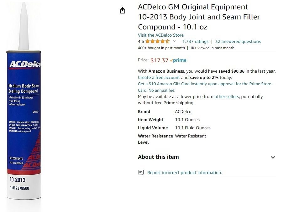

My only sealing I have done was to use silicone around the rubber light grommets on the corners but I need to remove both side rails to get to all the body seams.
I also want to fill the body channel where the roof is bonded to the sides. I used AC Delco 10-2013 joint sealer but the stuff is really gooey and doesn't flow very well.
It seals well and held up good, it's just a pain in the *** to work with.

I haven’t taken mine off yet. My headliner is currently out so I use the pb blaster. I figured there were seals under the rail. At least where the bolts go down through. I have some of that sealer made by 3M. It never really sets up. It stays gooey.
