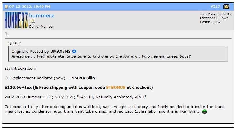

Where did you buy your SILLA radiator ?
Old Jul 25, 2024 | 02:12 PM
Posts: 9,017
Originally Posted by ski.dive
HUMMERZ-
I bought & installed over 12yrs ago:
Read If Your H3 Radiator Has Cracked or Leaked
