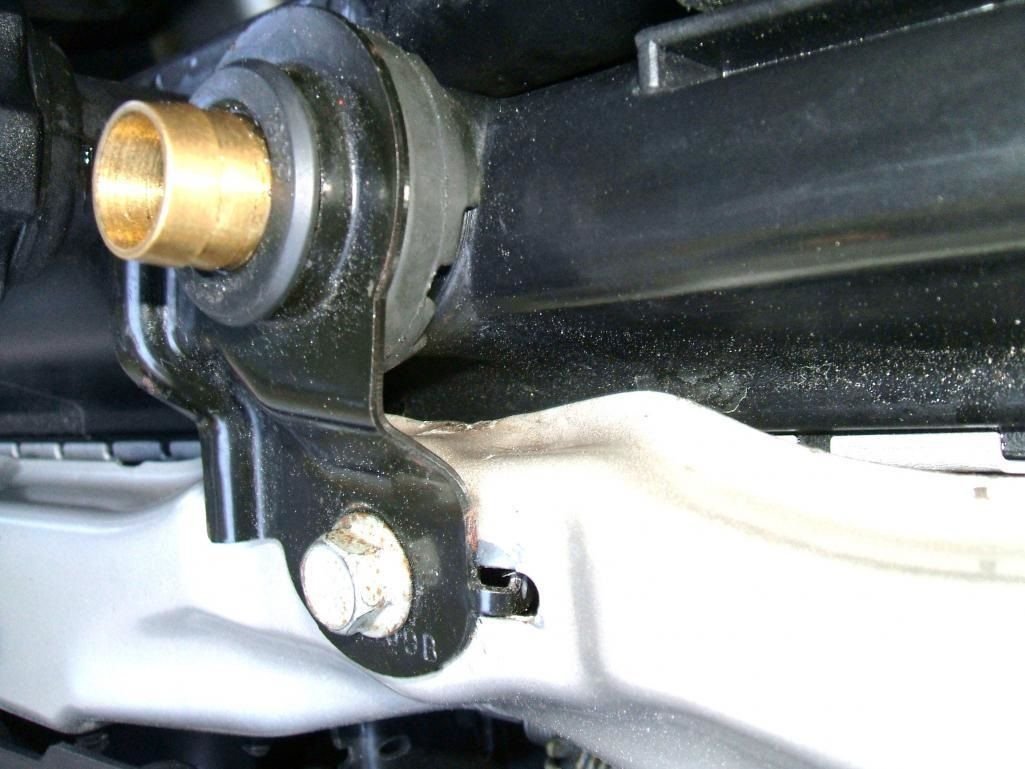

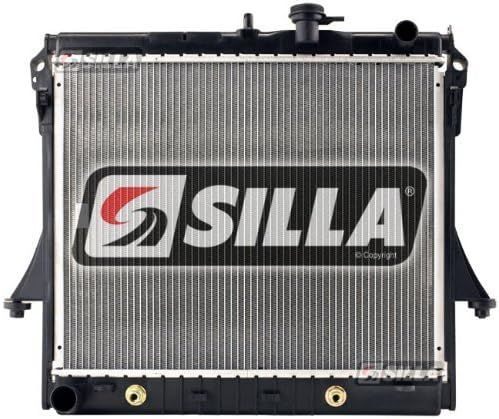

It has been necessary for me to replace the rad in my 07 H3 at least 4 to 5 times since 2011. Each time the pos cracks on top do to heat cycling.
after 2 acdelco, 1 oem gm... finally paid the big bucks at vato zone and got the lifetime one. Have had to replace it already once. At this rate it'll pay for itself in no time lol.
You must have missed my post from 12yrs ago>>> Read If Your H3 Radiator Has Cracked or Leaked
My SILLA radiator cost me around $110 shipped to my front door and it's still sealed to this day>>NO LEAK! OEM only lasted 5-1/2yrs.
Btw, my long term success also includes a mod on the upper mount(brass sleeve insert to prevent any flex on the upper tank)
