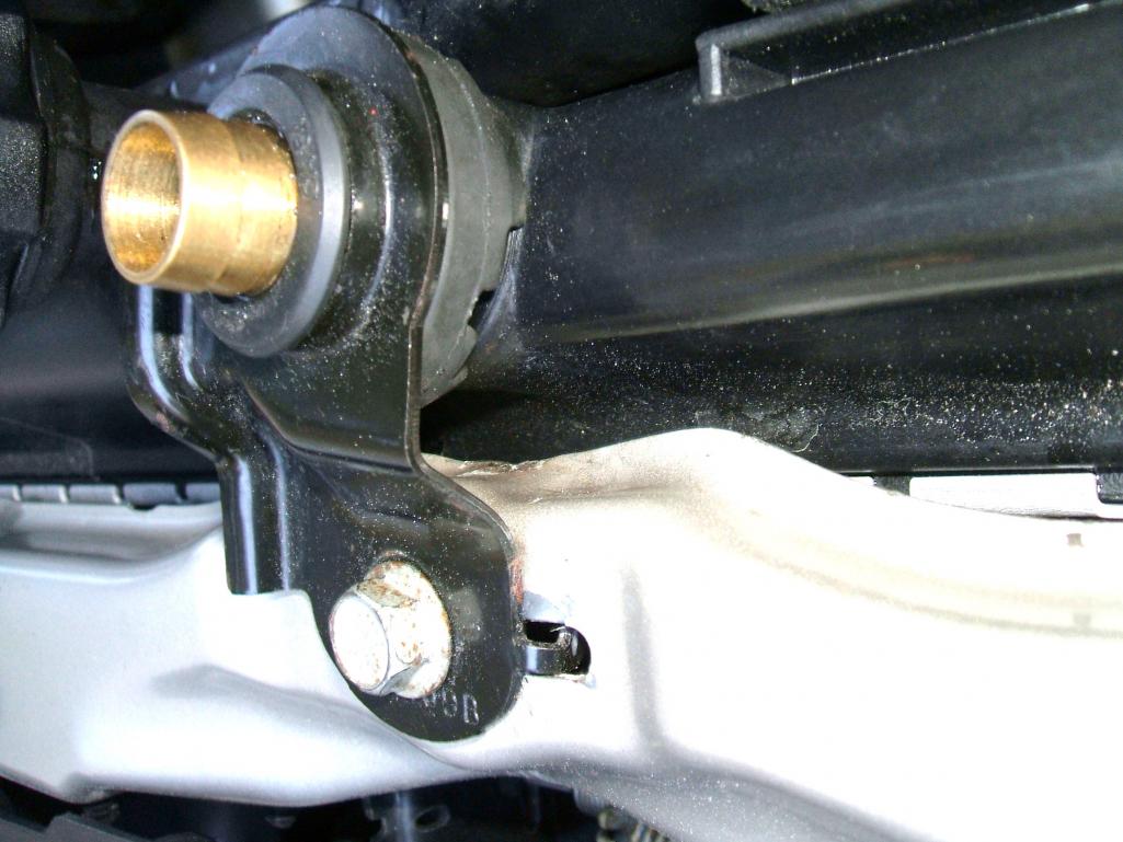

I took the top bracket off and I took my large channellocks and squeezed over the top of the radiator support, pinching the lip that faces directly at the filler neck. I also found a brass nipple that fits over the radiator mount post and inside the bracket bushing, now my radiator dont move hardly at all. GM should make a revised bushing or bracket to fix. That is what I noticed before I inserted the brass bushing, is the radiator flops back and forth alot. Now it is tight.. maybe I could get a patent? some bling bling for my hummer...

I think the LAST thing you want is a rigid rad mount. let it float on the hoses and the rubber in the bracket. If it touches the metal,cut it back like the guy said he did.
Thats why these things get rubber mounts, vibration is a killer.

My rad still has the rubber "insulator" mount on top & 2 on the bottom... I put an insert in the top mount, rubber bushing still intact, to prevent the excessive travel. The radiator I took out with a crack in the upper tank, dont look like it was hitting any metal (where it cracked) instead it appears to be a stress crack. Plastic expands and retracts when hot or cold, I just think the amount of travel the radiator had at the top ONLY (lower side mounts are tight), caused too much flex on the upper tank, resulting in a stress crack... I'm thinking of fabricating more "bushing" mounts for both sides of the top.. Yes, the radiator needs rubber bushings to flex, but flex too much is NOT good at all.
