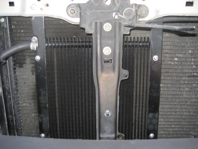

Just an update. After a few trips I saw little puffs of steam - no fluid just steam. I tried some Bar's leak and it worked for a few more trips. Then I saw a couple more puffs of steam.
I ordered a new radiator.
I installed a tranny cooler and bypassed the one in the radiator. Here is a picture.
