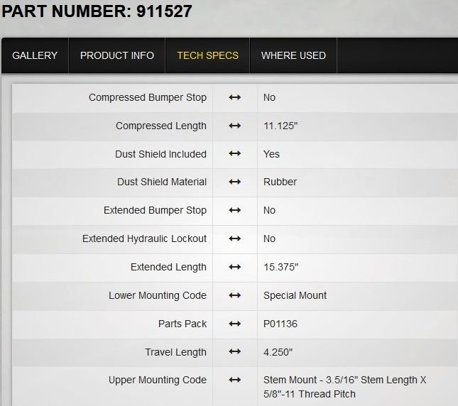

Getting ready to replace my worn out shocks. Got it narrowed down to either the Fox 2.0 or the Rancho RS9000XL. I've always liked/wanted the Fox 2.0s, but because I spend 90+% of my time on the pavement I'm leaning towards the Rancho for their 9-way adjustability as well as the cost difference (nearly $200). However, one of the specs on the Rancho has me concerned; on the fronts (RS999307) the Rancho lists the travel at just 1.74" (extended length 15.28"/compressed length 13.54") compared to the stock OEM shocks' 4.1" (ext 15.2"/comp 11.1"). So my question is whether or not that is relevant. Knowing that the shocks are mounted inboard from the tire, how much "travel" is actually needed at the shock on the H3? Is the 1.74" (at the shock) sufficient, or will the shock bottom out before the suspension? Anyone know for sure?

Seriously, guys? I know that the H3 has more than 2" of travel. I also know that shocks only move in a linear motion (I'm actually an engineer). Think about this; My Husqvarna 310 has over 12" of wheel travel, but the shock only has about 4" of travel (yes, there is also a linkage involved, but that's not the point). The point is that because the shock is mounted much closer to the pivot point, it doesn't need as much linear travel (yes, that's called geometry). Same with the H3: wheel travel is NOT the same as shock travel.
With the torsions at stock position, the LCA rests right against the bump stop, so the actual shock compression travel possible at that location is minimal, although I don't know how much droop the H3 will allow. With the torsions cranked up, I have about 3/4" gap at the bump stop. Now the shock is a bit outboard from there, but not much, so realistically, the shock can only compress about 1 1/2". I think this weekend I'll dig into it a bit more and see if I can get a clearer answer, including droop. Also waiting on a response from Rancho.
Here's what's interesting; Rancho's RS9000XL that they spec for the H3 with (their) 4" lift, while being longer (19.4" vs 15.28") to account for that lift STILL only has 2.11" of travel. Again, I find it hard to believe that a shock/suspension company that has been around as long as Rancho has would spec shocks that don't have enough travel for the vehicle they are listed for, including for THEIR OWN 4" lift kit. Anyone here with a Rancho lift want to chime in?

While all of that is true, it really is irrelevant IF the shock's length is sufficient for the mechanical limits of the suspension components. Even if you removed the shock, there is only a specific amount of travel in that system. If the shock doesn't bottom out or fully extend within it's mounted position throughout that system's range of motion, then your "finite" spring rate never comes into play.
Interestingly, on the H3, the stock shocks ARE indeed the limiting factor in droop. If you allow the suspension to fully droop, the upper stops (frame and UCA) do not hit as long as the shock's are installed. Remove the shock, and the suspension will drop a bit more, and those upper stops actually do come into play. But those stock shocks also have an internal rubber stop to buffer that. The Rancho shocks are about 1/10" longer at full extension than the stock shocks, and while I don't know if they also have that internal bumper, I have now seen several reports/pictures of the shaft being ripped out of the bottom of the shock when full extension/droop was reached (usually in a "tire off the ground" situation). So either they don't have that bumper, or the body's construction is weaker and not designed survive that limit (or both).
What I was interested in originally was whether the compressed length would physically limit the upper (compression) travel of the suspension. After more digging/research, I believe that the 2" of shock travel (at the shock mounts) may actually be enough to provide the full range of H3 suspension travel as designed, but their tendency to fail at full extension has removed the Rancho from my consideration anyway, so it's a moot point.
