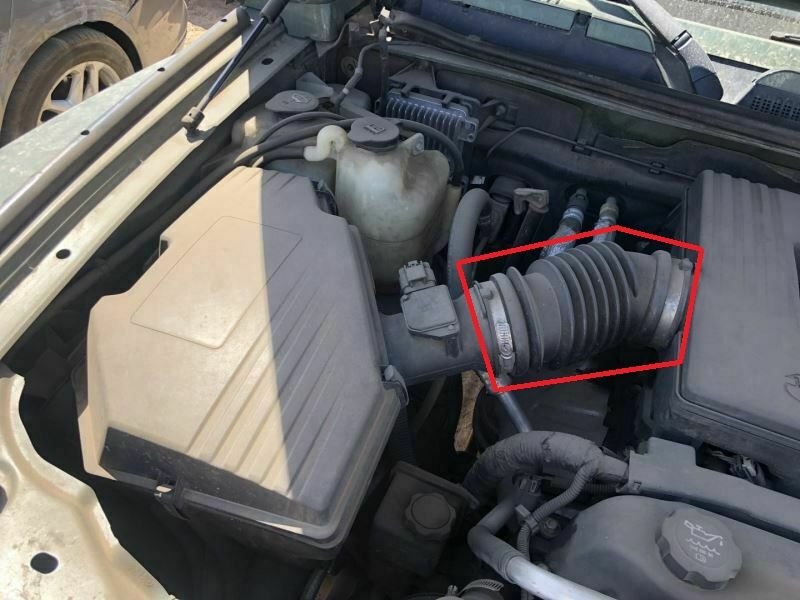

Did you check your CAI? Try REMOVING the air box cover,+AIR FILTER, and tube from the cai and let it run to operating temp, can drive around (avoid dusty roads). Post the results.

Well no luck hummerz. I disconnected at the air box to resonator pre maf sensor and she bucks and jumps on rpms. Installed it back into place, remove filter cover and filter with no change. She still stalls around 500rpm at idle halfway temp. If I hold 1200rpm she will stay running smooth but dies as soon as I let off to return to idle. I jumped the gun and change the tb cause mine looked rough and maf cause it was cheap. No change.
