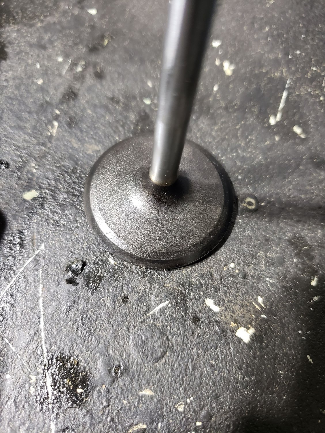

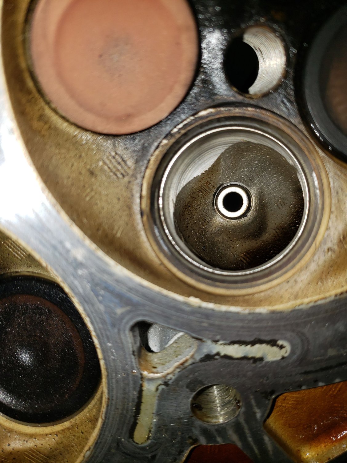

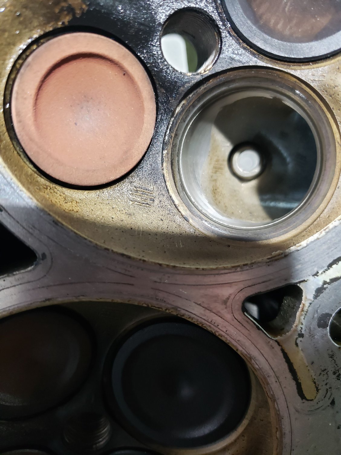

Thanks for the correction I did mean seats not seals. I will remove the valves tonight for a closer look at the seats and check to see if they are built up with carbon and or damaged pitted etc.

9 out of ten valve seats are worn irregular. Complete new head on route.
corr., reman. Got any pics of the valve seats? Is there a core charge?

VIN FALLS INTO THE GROUP OF JUNK SEATS 164411. AND YES IT IS A FULL REMAN, CAMS BEARINGS VALVES SPRINGS ETC.... COMPLETE. TOTAL FOR THE REPLACEMENT HEAD $1100.00 $125.00 CORE WHICH STILL WORKED OUT TO BE LESS THEN REPAIR ON THIS OG HEAD.
